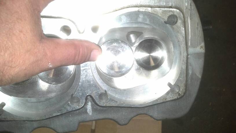

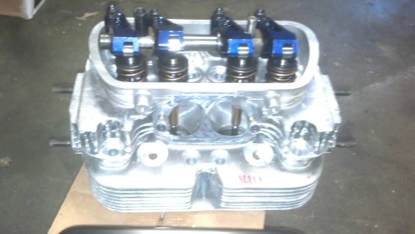

these are 044 wedge port heads that I am getting ready to put on a 2500

If I were building that engine I would opt for the los panchito CNC ported 044's. I also would run no bigger than dual 40mm carbs.

You can use your Weber 44's on the motor you are building. Just choke them down a little bit and they will work great. That's all you have to do. Save your old chokes (venturis) incase you want to build a big motor soem day you can switch them back.
