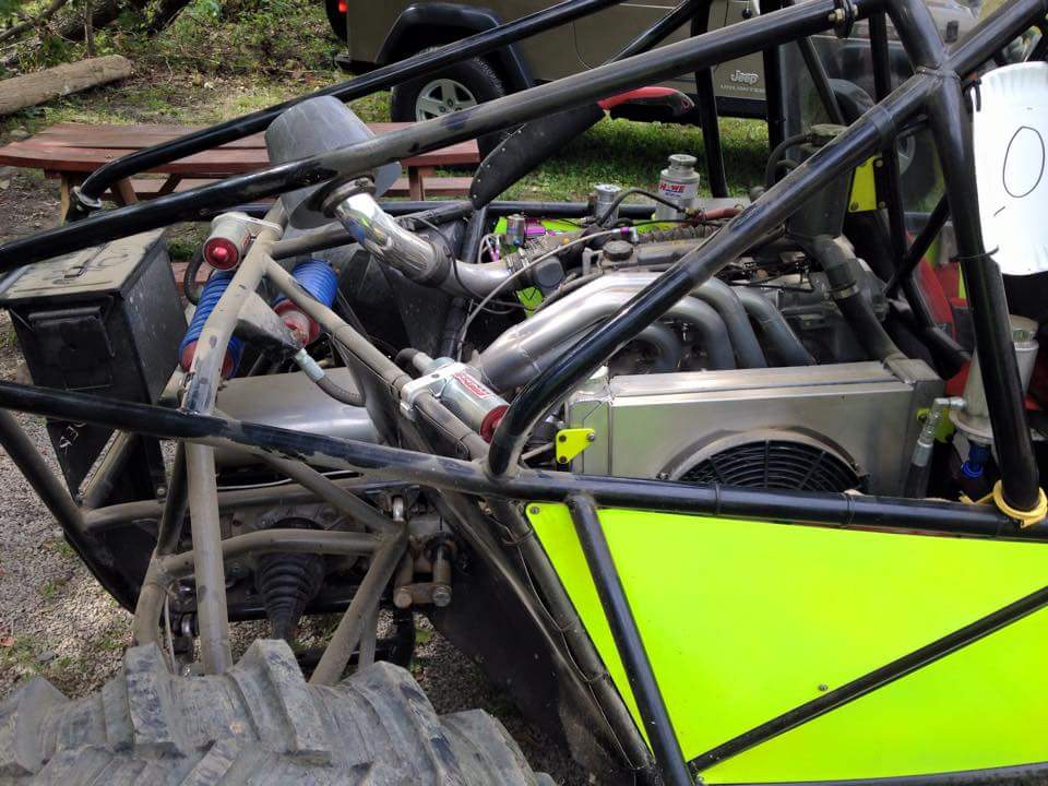

Just seen this mid turbo ecotec on fb. Anyone know what he is running? It's an auto looks bad ass.
PostPosted: Thu Sep 03, 2015 9:52 pm
Posts: 465
Location: Northwest Indiana
Gotta be something pretty salty to fit in that small of a space and be an auto... Transaxle engineering fields 3 speed maybe... I talked to them too. $14k for that trans. I like the cantilever rear suspension.
