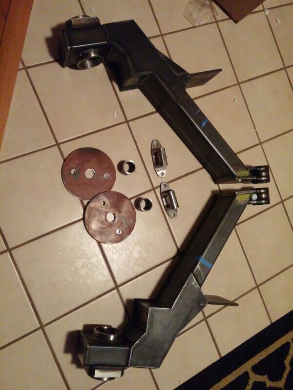

PostPosted: Fri Feb 20, 2015 8:52 pm
Got most stuff off of my rear trailing arms. Preparing for Mike's arms.

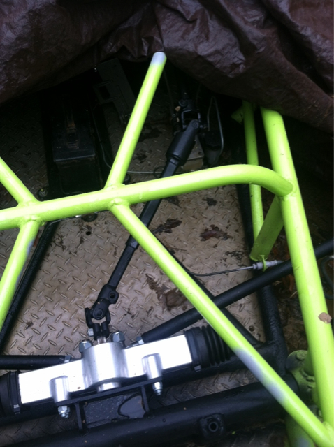

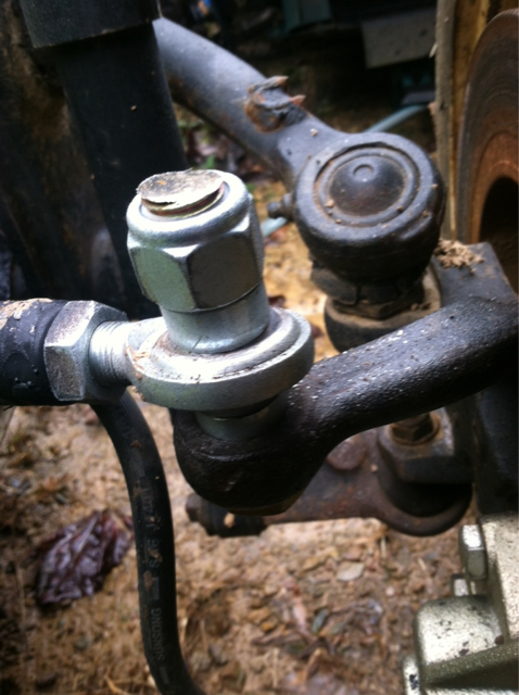

Got the rack and pinion with heim joints installed
PostPosted: Sat Mar 14, 2015 7:48 pm
I think your missing the high misalignment spacers on all those heims , you gotta buy them separate then the heims. 2 per heim if not they will probably bind up and you will be pissed if you ruin them.
PostPosted: Sat Mar 14, 2015 7:51 pm
Are those homemade spacers or just different looking ones then what I'm used to

Got MadMikes rear arms installed, bearings and brake brackets. Now to get my axles in and set my limits.

Posts: 56
Location: SouthEast Ky.
They are home made spacers
