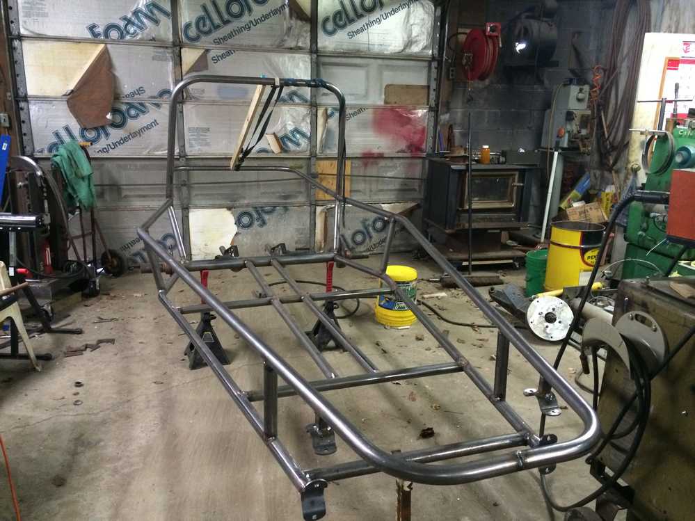

Today the frame came off the jig. (it was returned today as MY shop is full inside and it is in town so no outside storage) I started welding on the bottom side. I will bend the rest of the hoops soon and it will look more like a buggy. For some reason I have been having trouble getting the 1" tubing for the bracing (no stock)
Happy Hunting

I bent and birdsmouthed the overhead bars and bent the windshield bar tonight hopefully I will get them fitted and tacked in tomorrow evening
Happy Hunting
archie
