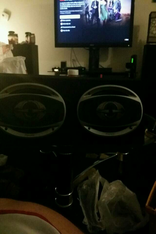

Good deal! :D hopefully with a little luck everything will come apart and go back together with no problem, or so I hope. I'll make sure to post some pics just in case there is something I miss from my visual inspection. Also, I'm putting a stereo system in the buggy tomorrow.
