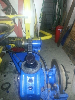

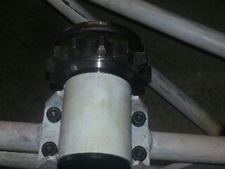

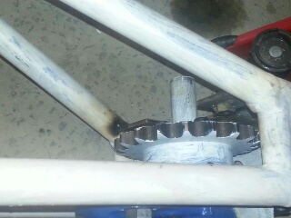

here are a couple of pics...
When in doubt, make it shout!

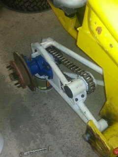

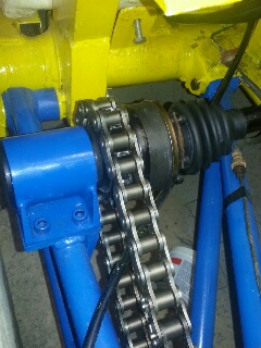

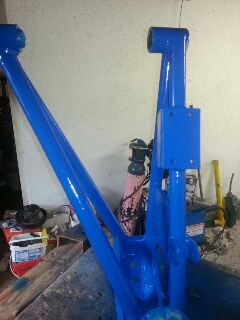

and a few more

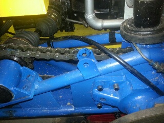

morning guys, this is the finished product. Do you think it will grenade on the second outing? (withstood the first) or should it be ok?

What type of caliper with the E brake?

Nice work! It looks like you decided to
keep the final drive ratio 1:1`(front sprocket
same diameter as rearward sprocket).
While this is a "safe" design, you can get more
bang for your buck if you increase the diameter
of the rearward sprocket and go to a taller tire.
Shift revs and transmission gearing can stay
the same when the correct tire height is used.
In theory, underdriving the final drive along
with taller tires will improve clutch life (less slipping),
provide better climbing at lower RPMs and increase
launch response (based on road traction conditions of course).

The calliper is from a vw golf/ audi. It works well havin separate e brakes for each rear weel. Helps with steering.
The ratio has been reduced. It's1.4 to 1. 1st gear with the 33" tires is a monster.
Just enough speed and a huge amount of power.

Nice . Just curious are the chains adj ?

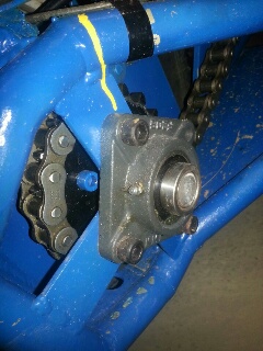

Image WA0027 you can see a half link used to help get the length right.

Posts: 15
Thanks guys. No, the chains aren't adjustable, however... if i put a spacer plate under the front hub assembly, it will tension it up.
