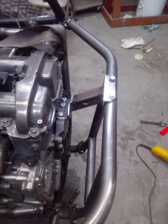

Well I am 90% put back together, I am waiting on I hope the last parts order with all my oil lines and AN fitting should be here tomorrow. I did decide to change my rear engine mount, It would have probably worked fine in a woods buggy but in the race world your rear cage gets a little love every once in a while. I didn't want that mount shoved through the engine block when a Trophy truck hits meet at 80.
PostPosted: Wed Apr 23, 2014 11:26 am

Drivers side mount was a little tight on space with the header.
