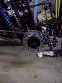

PostPosted: Thu Mar 06, 2014 1:52 am
Posts: 80
New micro stub kits in and one new axle and cv's. Alpha fab ecotec will be here Friday!
