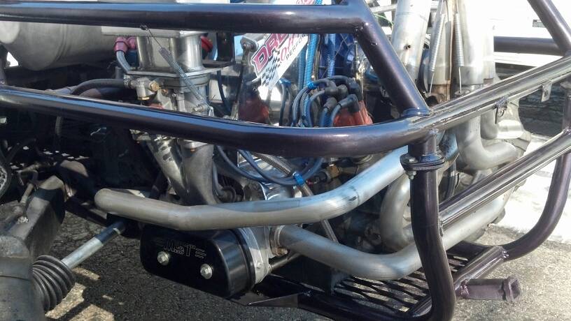

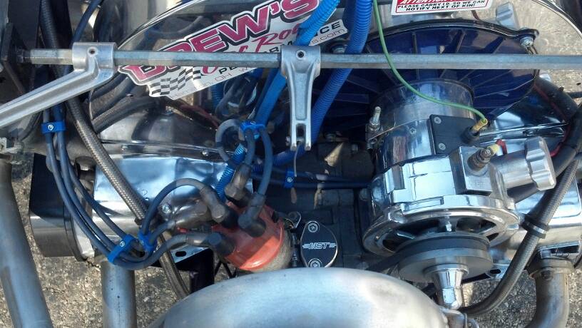

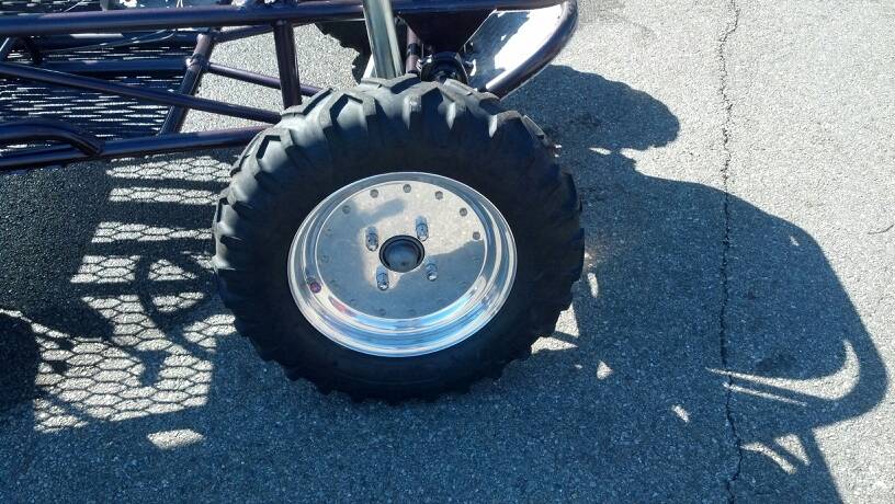

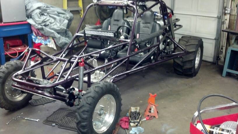

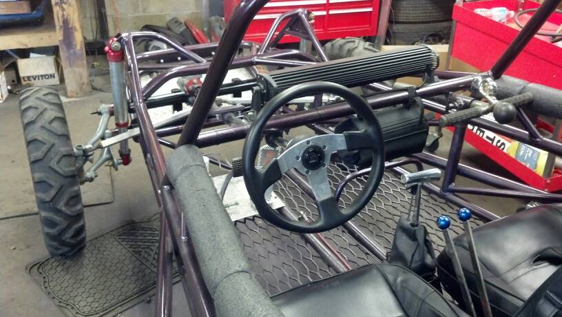

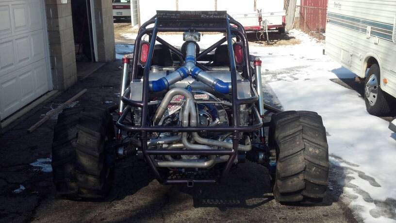

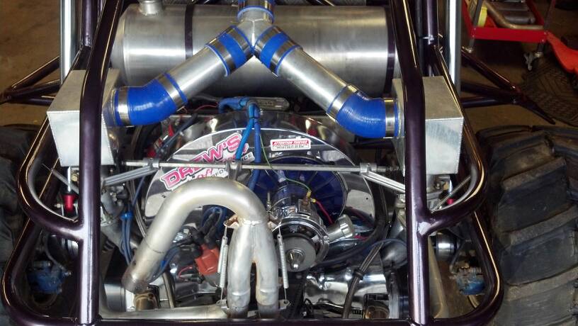

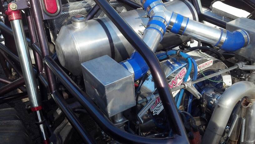

Got my first buggy at 18. Traded a 1976 v 8 Mustang for it I've got seriously into bugging about six or seven years ago . I am originally from Manchester Kentucky was down there visiting my dad and went to a DNK hill climb. From that point on could not wait to build a nice hill climbing buggy . I built a Cobra 98 beeline . The motor is a 2500 built out of junk lol. The transmission is A 6 rib with weddle gears done by Chuck Jones . The front suspension... the beam has been modified just a little race runner 2.0 air shocks torsion eliminators Center steer . The rear suspension is 3 X 3 arms built by Chuck Jones 2.0 race runner air shocks . Has aluminum beadlock wheel's on the rear with 23 degree firestones the front wheels are aluminum wheels with home plate tires 590 . Has scat suspension seats .....And i am the only one that's ever owned this buggy that's becouse i built this from ground up
