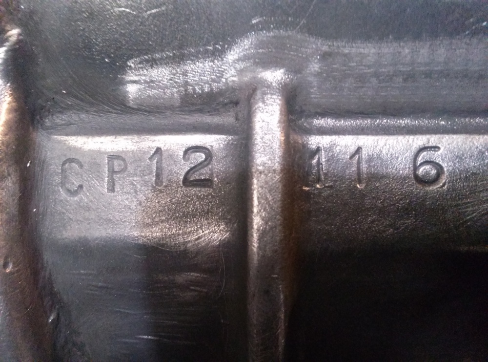

File comment: This was stamped on the bottom, can someone tell me what it means, there is a 6 after the #11?

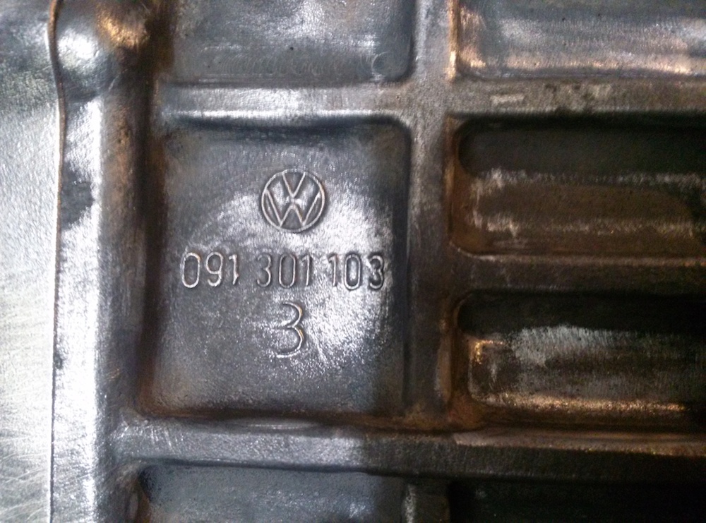

File comment: Here is the SER#

-Can anybody tell me why there are stamped #'s on the bottom? Rebuilt at some time maybe?

Still wondering about the stamped #s on the bottom?

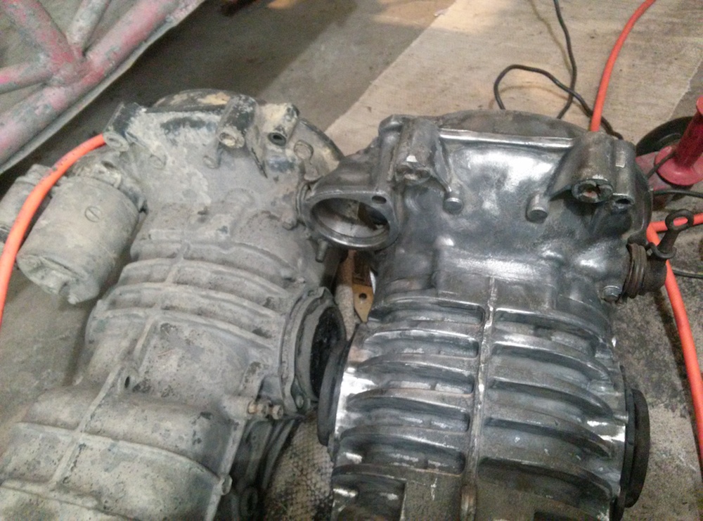

I like that first attachment you posted at the top — I've never seen a 002 & 091 next to each other, it looks like the CV output sits farther back on the 091? Having a 002 myself, Im very interested in anything you had to do to get the 091 to fit. New front mount? Need to modify the rear mount or did you use the ears?
PostPosted: Tue Feb 11, 2014 11:31 am
Unclejerm,
I redid my front mount because I did not want the 10deg tilt anymore, I built the first one so I just fabbed up the second, I used the standard strap for the rear but only used the lower section that bolts to the fram horns and lower trans mounts. If you look close at my build I also redid the bracing to the rear frame horns and put in a cross bar with tabs to mount to the trans upper mounts, I am also going to use the rear most stock engine mount for rear support, just above the pulley.

Thanks for getting back, it looks nice and solid, I don't think you'll have any issues with the trans moving. I was thinking about using the stock rear engine mount also, but ultimately it interfered with my radiator location. There are a lot of possible mounting locations on the side of the block, but none of them are on a flush surface making it more difficult than the usual motor mount.
PostPosted: Tue Feb 11, 2014 9:06 pm
I aslo considered the side mounts but I could only go from my skid plate up till I saw the rear mount. I have the plate ready just got to mount it... will get picts when i do.
