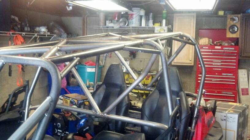

Odyknuck wrote:
When plumber bills cage folded up he was going 10MPH and rolled down a hill. If you notice the rear of the cage did not fold as it was supported. It put him in the hospital with a concusion. Hope you plan on coming down from the top front of the cage to the front of the frame. It's not as much about the wall thickness as it is the geometry of the cage.
This.
It doesn't matter if you make the cage from 2" solid bar, if you don't triangulate it, it will fold like a house of cards.
PostPosted: Sat Jan 18, 2014 3:28 am
I will roll it real soon and we will see how strong it really is..... :?
PostPosted: Sat Jan 18, 2014 9:24 am
I dont get what the big beal with the front hope design is as almost all buggy are caged this way.. yes plumerbills folded because it was a four seater with a huge open span with no support.
PostPosted: Sat Jan 18, 2014 9:40 am
A good percentages of buggy's utilizing the hoop design is a matter of economics than being the correct way to build a cage in compression.
PostPosted: Sat Jan 18, 2014 11:28 am
so this is the incorrect way to make a cage? http://woodsbuggy.com/forum/buggy-build ... nes#p75754
PostPosted: Sat Jan 18, 2014 12:56 pm
The front 2 bars go to the bumper....They un bolt so if i ever need to take the whole cage off i can.
PostPosted: Sun Jan 19, 2014 9:15 am
Posts: 709
Location: UK
Maybe, but there's a whole lot of buggies I wouldn't be happy riding around in too ;)
PostPosted: Sun Jan 19, 2014 2:00 pm

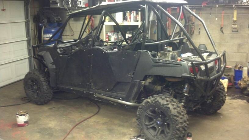

People this thing is not done yet ...Trust me it's not folding i have built race cars for a long time i under stand hitting your top and being safe ....i love the input tho thanks..

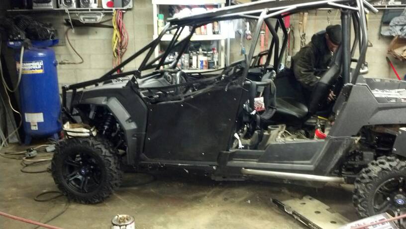

PostPosted: Sun Jan 19, 2014 2:05 pm

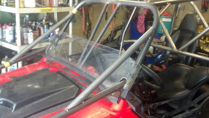

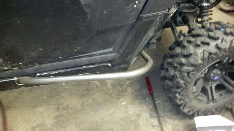

PostPosted: Wed Jan 22, 2014 4:44 pm

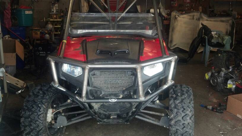

Worked on the RZR last night .... Starting to come together now
PostPosted: Wed Jan 22, 2014 5:24 pm
thats a lot of roll cage 8)
PostPosted: Wed Jan 22, 2014 6:31 pm
I agree Rick I think I over caged it but it is safe and I would roll it without a worry lol . Hell if I ever see you in the woods me and you'll get it out and be the first to roll it.

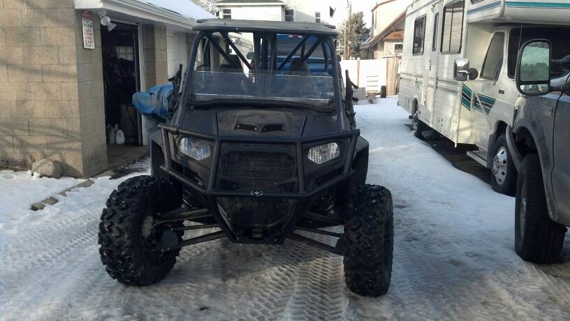

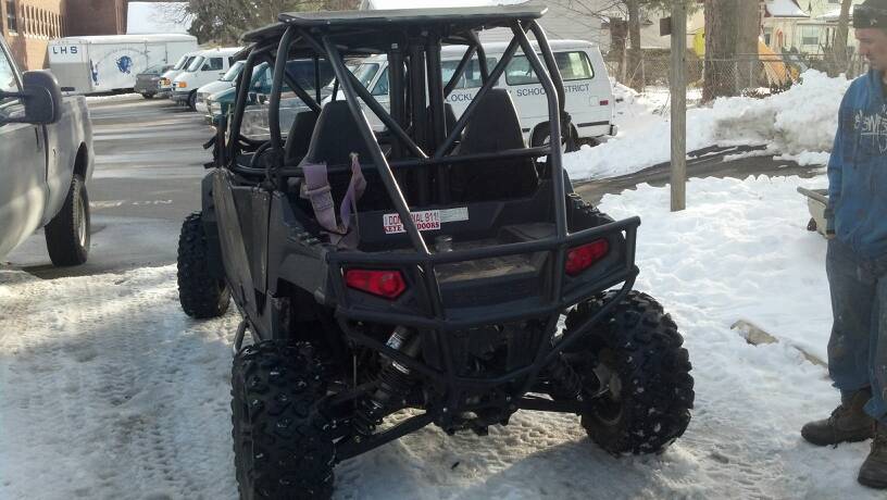

The rzr is getting close....a few more pics for you guys rinolined the body got the cage back on....
PostPosted: Wed Feb 12, 2014 10:39 pm
A few new pictures

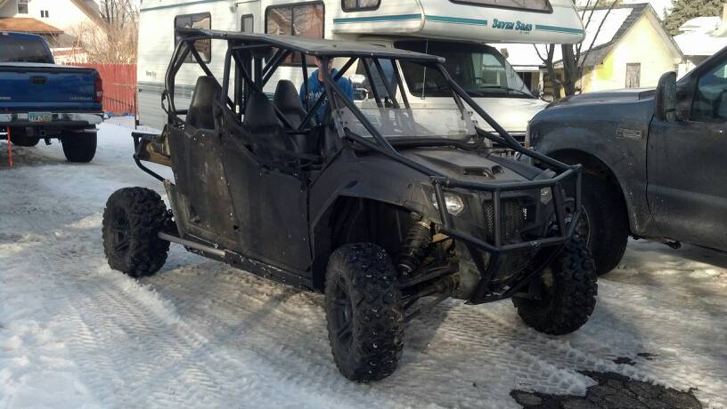

PostPosted: Thu Feb 13, 2014 10:47 pm
Got the razor outside today
