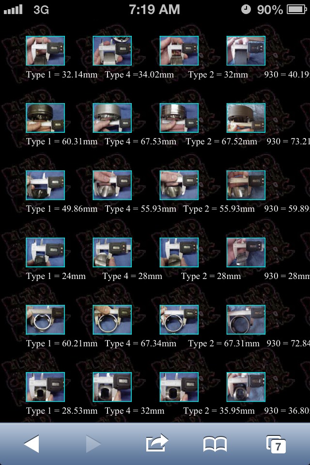

Yeah that's what I might do. I was reading an bug stars are 24mm thick an bus is 28mm so if I took 4mm off the bus star or the stop on the axle don't kno witch would be better it should work
