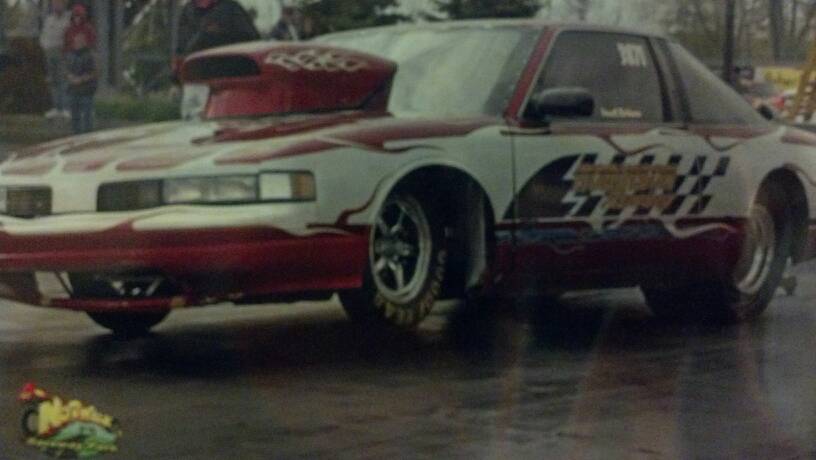

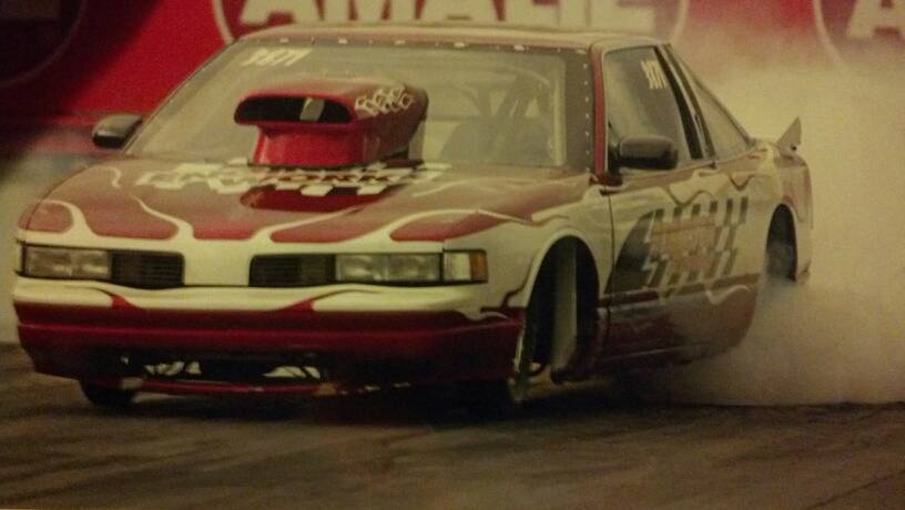

I know a little bit about drag racing here's a couple of pics of one of my old cars
