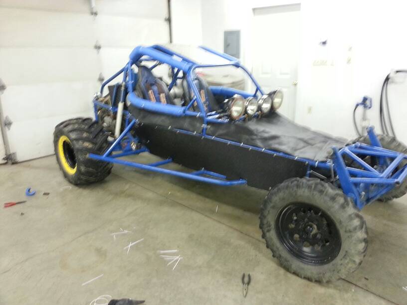

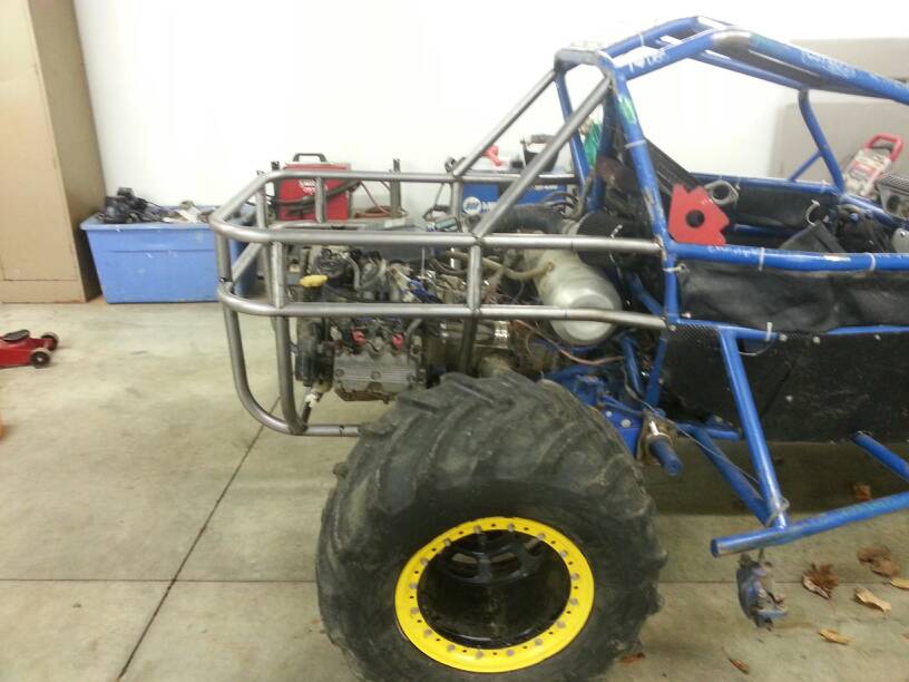

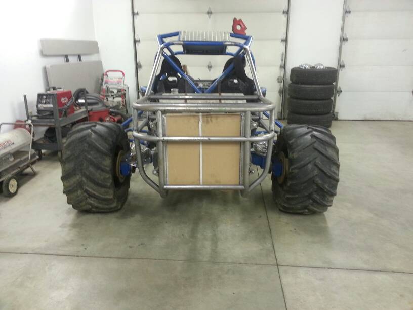

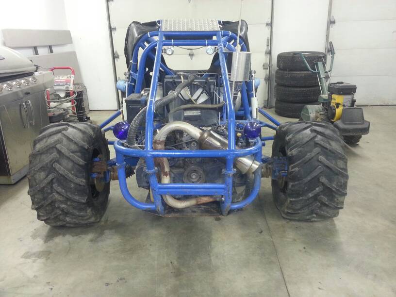

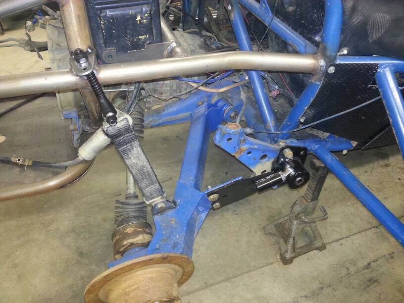

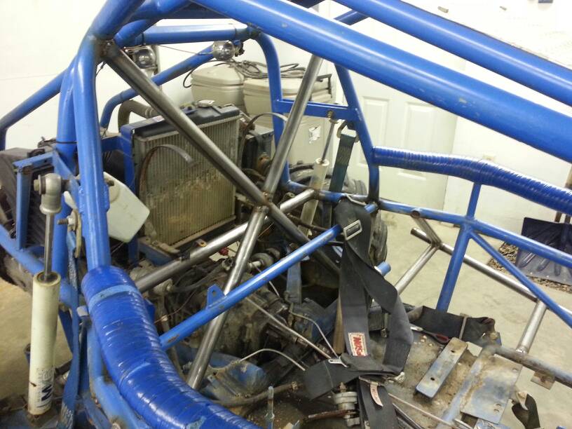

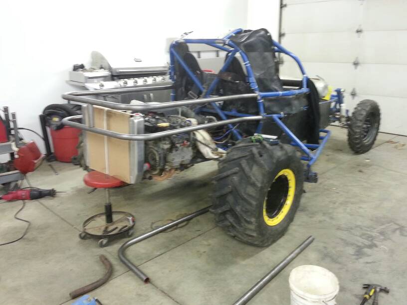

This is what I started with back in february first things I started off with were new tree bars and x brace the stuff I cut out was made from conduit

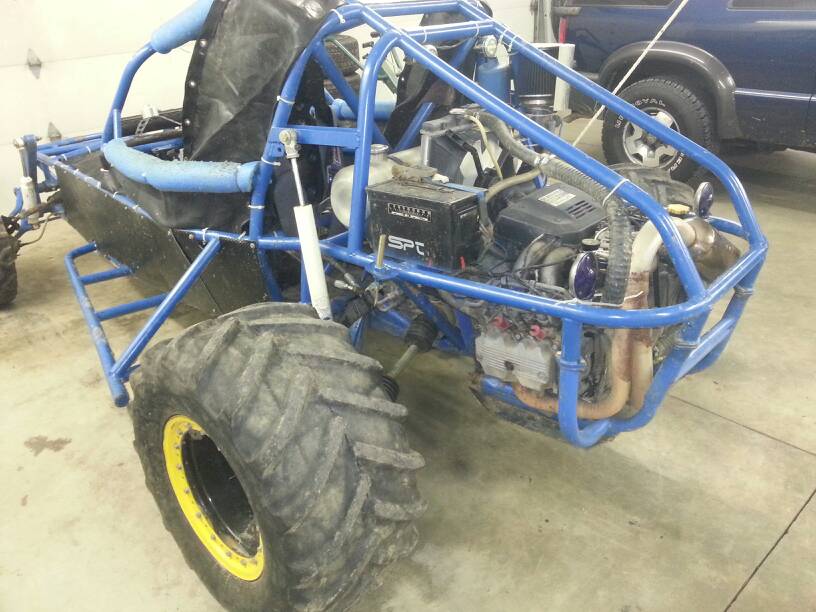

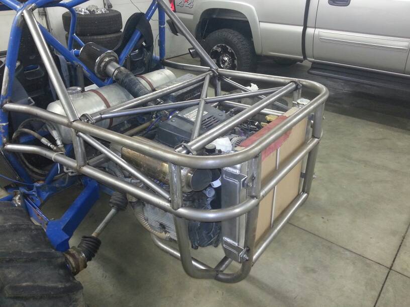

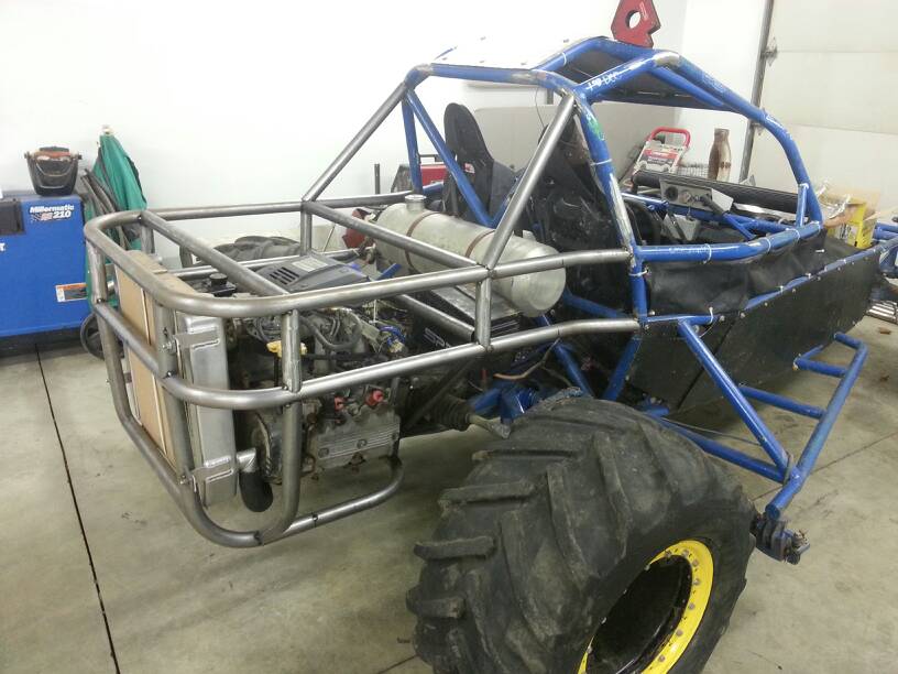

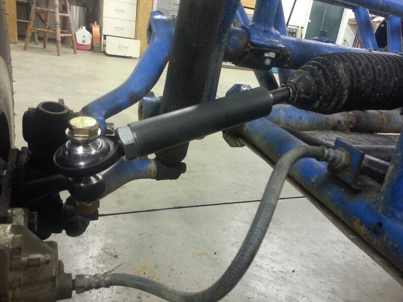

Fixed the tie rod problem and rode it most of summer then had to replace the motor and get the trans rebuilt at the same time it has a 2.2 subaru with a 6 rib

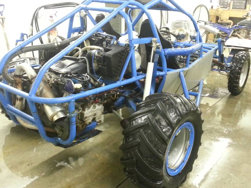

Swithced to a set of mad mikes 2x3s and getting his torsion eliminators and putting coil overs on it

PostPosted: Fri Nov 22, 2013 5:09 am

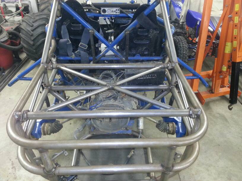

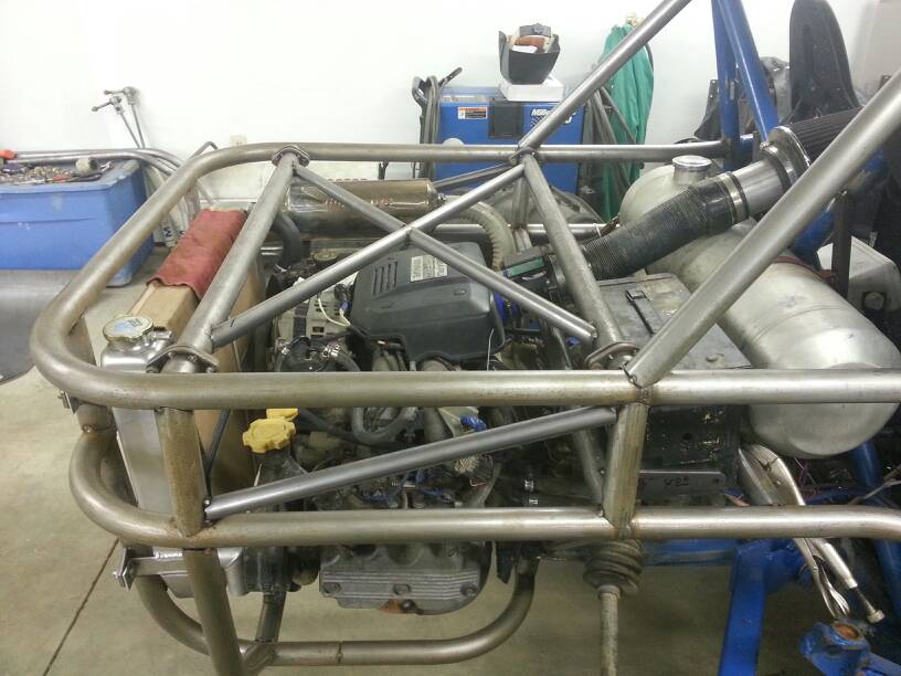

Looks good. Are you going to weld some flanges to make the rear cage unbolt or just leave it welded solid? Chad :mrgreen:
PostPosted: Fri Nov 22, 2013 5:55 am
Posts: 67
Lol the ones going across the top will have the flanges

The whole back of the frame being tweaked was part of the reason I was doing this it bothered me

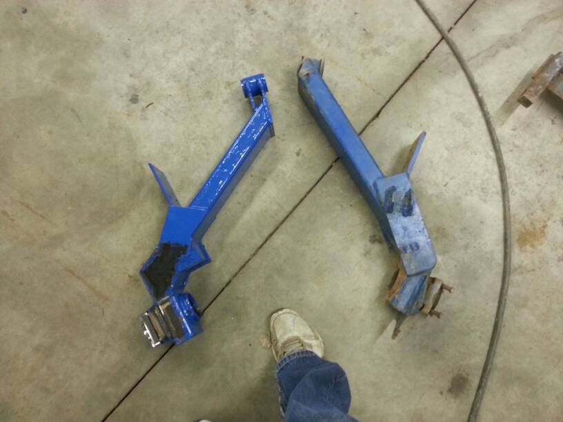

I hear ya I wanted to do something with it too but at the time I had it I didn't have a welder bender or funds too do it I like what you have done with it though what did you do with the sawyer arms they still straight and good?
PostPosted: Fri Nov 22, 2013 6:41 pm
Posts: 67
I broke the passenger arm but i got it straght and rewelded but I have no use for them

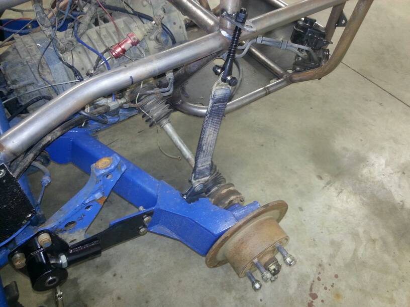

PostPosted: Thu Nov 28, 2013 9:43 pm
Posts: 67

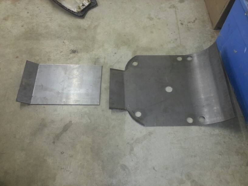

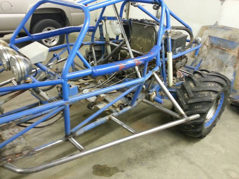

Exhaust made computer mounted and skid plates

PostPosted: Mon Dec 09, 2013 6:55 pm
Posts: 67

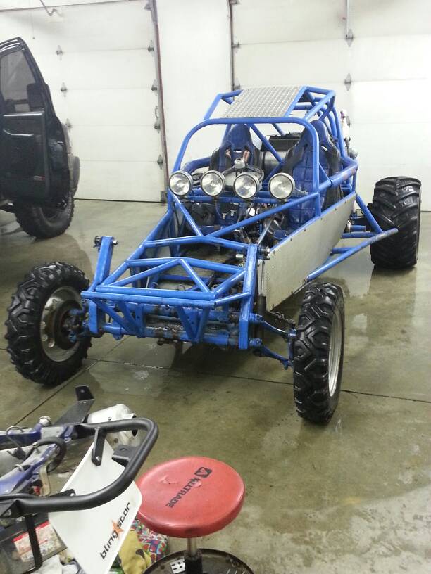

Elminators installed and my limit straps setup figured out my wheel travel and I wanna order my coil overs soon just need to weigh the car. Does anyone know where I could find scales?
