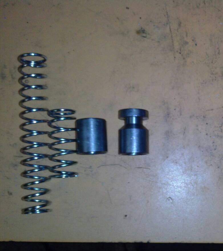

I got an external oil cooler and it came with new relief pistons and springs. The springs are a lot stiffer than the old ones and one of the pistons is different than stock. Should I put these in or use the old ones? Where does the different piston go? I'm eliminating the shroud cooler and running everything through the full flow. The cooler kit is supposed to run off the adapter that replaces the shroud cooler.

Keep the shroud cooler ...And run the other cooler with it. Keep the old springs too .

If you must use the remote oil cooler, run it from the full flow fittings, not the oil cooler adapter. Always KEEP the stock oil cooler in place no matter what kind it is. This is important.

The oil also cools the engine as well as the air flow. The oil draws heat away from the heads as it runs back into the engine. The heads are what you need to be concerned about running cooler, not so much the cylinders. Removing the stock cooler will not really let the head on that side run much cooler, Alot of the cooliong air for the head on that side actually goes over top of the oil cooler. Having a steady stream of air moving across the oil cooler is very important for the proper cooling of the motor. The old style oil cooler mounted inside the fan shroud is not the greatest BUT it works. If you plan on running your motor really hard, it will benefit you much more to switch to a doghouse system with a type 4 cooler mounted in place of the type 1. This is all you really need. If you feel like you really have to remove the stock oil cooler, it would be wise to run the aftermarket oil cooler from the oil pump full flow fittings instead of the stock cooler location. It's much more effecient this way. A cooling fan is a must if the stock cooler is removed. This fan must be thermostatically controlled.
The only time you ever need a remote oil cooler is if your compression ratio is set over 9.5-1. Anything else, the stock doghouse cooler will do just fine. If you run around all the time with it matted to the floor trying to blow it up, nothing will work.
My opinion, I would spend the money on a doghouse shroud and doghouse oil cooler and the wider cooling fan before I ever spent money on a remote oil cooler.
