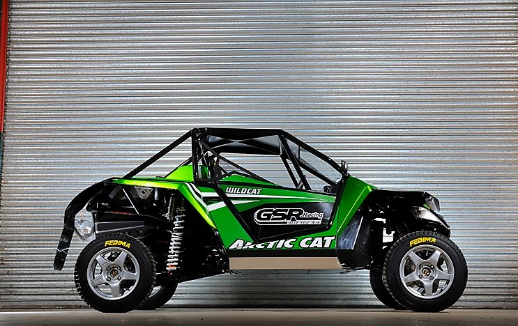

Here you go:
File comment: SxS Roll Cage
CDS or T45 (similar to your 4140), MSA and FIA approved, bolt in rear diagonal/cross available too.
PostPosted: Mon Jan 20, 2014 9:28 am
Hey, I have one of those! :mrgreen:
PostPosted: Mon Jan 20, 2014 10:46 am
I want one they look really nice...... :?:
