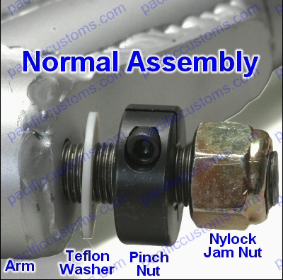

New buggy owner here, need to either replace my urethane bushings or go back to needle bearings (leaning towards the needle bearings). Previous owner tightened the bushings down so much they cracked. Just curious what some other thru rod setups look like - anyone running a thru rod with needle bearings?
My Setup:
After a lot of research I guess my setup is missing the pich nuts and teflon washers too.

i would run the white bushings and just snug them , they will live a long happy life ! 8) on mine i welded the nut with a washer behind it on one side and the other i doubled nutted it with a metal washer behind . a buddy was having issues with the clamp style not holding so i just followed his wisdom .... lol

I run blue bushings (not sure who makes them, got from mckenzies) they dont crack as easy as the white saco ones. Then I cut the "spacer" off and turn down some aluminum spacers. For a thru-rod I just use a piece of grade 8 all thread with a nut welded on one end and 2 thin nuts on the other and plain old sae flat washers under them. everything else I tried just lead to issues down the road.

Thanks RaceBugg, unfortunately I already ordered all my stuff. Found the black urethane bushings i was looking for here:http://www.socalautoparts.com/product_info.php/bugpack-trailing-arm-bushings-bug-ghia-inner-outer-bushings-black-urethane-p-13338. Sent them what I had and they said they will fit. Now if I can just get the wheels off the spindles!
Im going to use thread lock on everything and see how it goes. But I glad you posted because if I start having issues I will try your method. How about a close up of those aluminum spacers?

This is how I do mine. 1/4" brass and locking threaded shaft collar.

Thanks MadMike that's almost exactly the new parts i have now (I'm just waiting on my bushings to get here). But yours is a really clean looking setup with the brass collars - I dig it. ...only thing is - and I'm sure its fine like it is ... but I'd have to add a nylon lock nut on the end with loctite just for POM insurance. In any case - very nice job.
