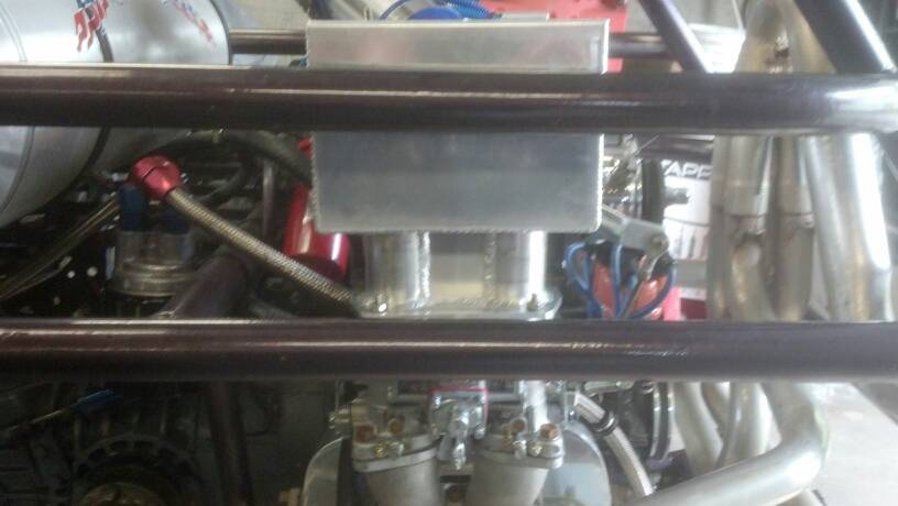

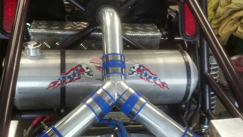

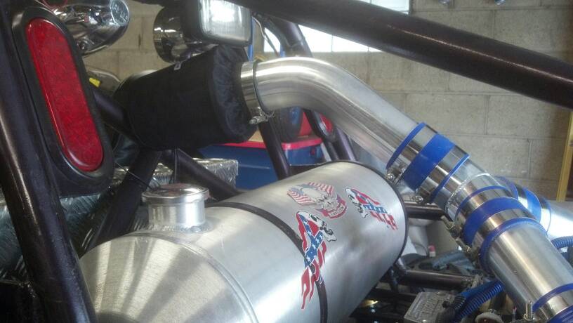

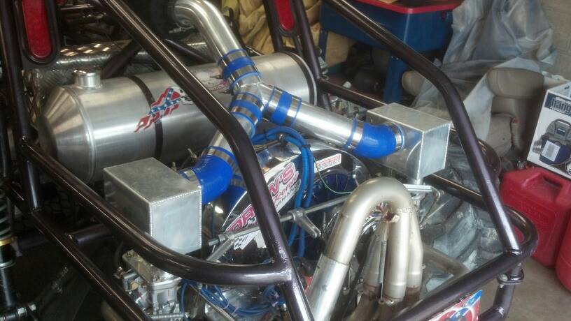

This system here works great it is sealed at the carburetors and as always drawing fresh cool air from the center of the buggy . And stead of hot air above the head and the mud and dirt from the tires don't affect the filters it is a little costly but personally I say it's the best system out there
