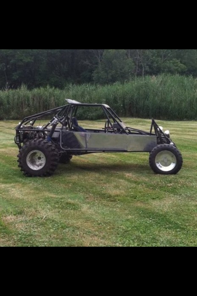

Here is some pictures of what she Looks like now , just need to get some extra time to finish her up and go ride !
PostPosted: Mon Sep 09, 2013 7:51 am
ImageUploadedByWoodsBuggy1378727417.818190.jpg [227.53 KiB]
Downloaded 71 times
ImageUploadedByWoodsBuggy1378727444.401862.jpg [237.94 KiB]
Downloaded 71 times
ImageUploadedByWoodsBuggy1378727488.721491.jpg [270.93 KiB]
Downloaded 71 times
