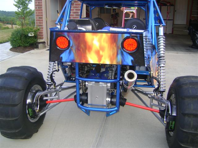

when i built my motorcycle powered rail I did alot of investigating on trans and gearboxes. The best one out there has to be the Jeffco if you want a diff but it is costly. The RPM is a real good one if you don't want a diff and it is half the price as a Jeffco. The transworks trans does not hold up very well from what everybody told me. You have to turn the bike motor side ways to make this one work. There is a site called minibuggy.net go there and look around.
