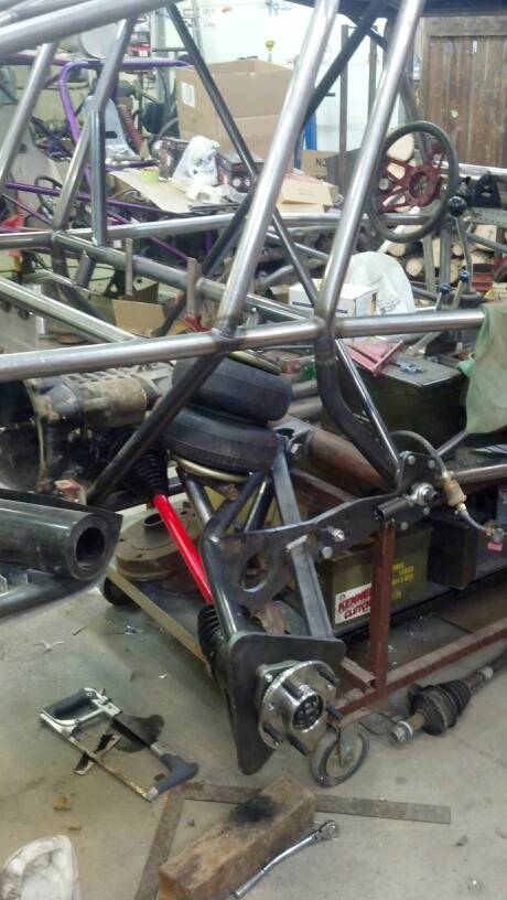

PostPosted: Wed Nov 06, 2013 8:26 pm

PostPosted: Wed Nov 06, 2013 8:45 pm
Image in the pic it looks like the bags attach to the bar under the fuel tank....there is actually a thick wall tube behind that one that the top of the bags mount to...and a 3 point mount on trailing arm

Location: ellwood city pa
idk why there sideways but that's how me and my brother did mine and yes u have to run torsion eliminators that's a must danspermorfanceparts has what you need I think 150 for them plus shipping maybe a couple dollars more
when we mounted mine we bolted and made sure to cycle through your travel to make sure it looked all right we didn't have no degree finder or anything like that but seems to ride nice for the hour I had on it if you have the know how u could do some real nice set up like I think mad mikes he has swivels and everything on his looks real nice and neat

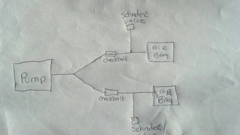

If you put a pump onboard you have to run one way checkballs before each bag, otherwise when the pressure increases in one bag it affects the other.
PostPosted: Fri Nov 08, 2013 10:02 am
Here is a crude diagram that may help
PostPosted: Fri Nov 08, 2013 10:03 am
Sorry schrader valve
