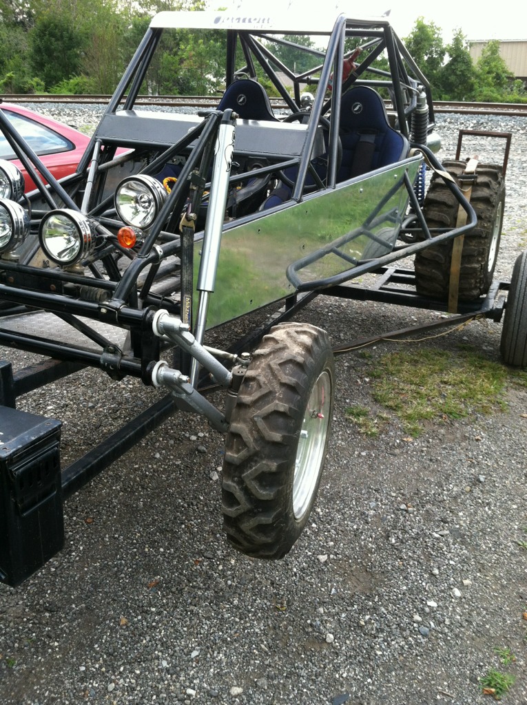

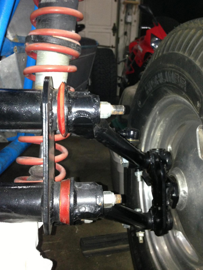

New buggy owner here, need to either replace my urethane bushings or go back to needle bearings (leaning towards the needle bearings). Previous owner tightened the bushings down so much they cracked. Just curious what some other thru rod setups look like - anyone running a thru rod with needle bearings?
My Setup:

i would run the white bushings and just snug them , they will live a long happy life ! 8) on mine i welded the nut with a washer behind it on one side and the other i doubled nutted it with a metal washer behind . a buddy was having issues with the clamp style not holding so i just followed his wisdom .... lol

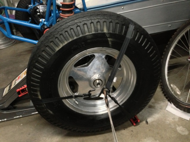

Which brings up a new issue... Im embarrassed to say this, but I can't get the wheel off the spindle??? I don't have a clue what could be holding it on. I can pull it about 3/4" and then something pulls it right back? After the video I tugged harder and harder until it was literally scooting the front of my buggy towards me. He's a vid...

It's odd, I've never had that happen, even more odd is the passenger side is identical - stops after 3/4" and then springs back! Should I just strap it to my truck and slowly pull it? Any suggestions? Need wheels off to get the thru rods and arms out to replace bushings.

Try to get behind it and get seal out and it should come off then you can work on getting bearing off.

Using three ratchet straps I pulled from the center of the wheel. I pulled so much that I was afraid I was going to bend the trailing arms or the axle beam. Any other ideas on what might be holding it on there? The pinch bolt is on just the end of the spindle in case the wheel popped free (I didn't want it shooting across my garage).

I would try scissor jack or bottle jack between arm and rim.

Urethane bushings aren't the best choice for a coil over or airshock suspension, too much compliance in the material. That's why it needed to be tightened all the time.
Try throwing some heat at the inner bearing, your going to need to replace all the bearings and seal anyway. Heat it up and let it cool several times it should come loose. Try a block of wood between the frame and the inside of the wheel behind the beam. Turn into the block and use a dead drop soft face hammer on the front side.

Just thought I owed it to you guys who replied trying to help me get my wheel off - to let you know that I was able to get them off today.
My dad and my cousin (who is to blame for giving me the woodsbuggy-bug) came over and we pulled the whole spindle off the arms with the wheel still attached. Then put it on a trailer v-frame and found a bolt small enough to sit in the dimple on the end of the spindle. Then started lightly hitting with a 5lb sledge hammer harder and harder until the spindle fell out the bottom of the V frame. Repeated on passenger side.
I have combo spindles and the inner bearing on both left and right wheels had come apart in the wheel somehow? But they spun smooth as butter, would never know it! Also I guess somewhere in those inner bearings is a spring??? (Ill try to post pics tomorrow) but that must have been what was pulling the wheel back in the video I posted earlier.
