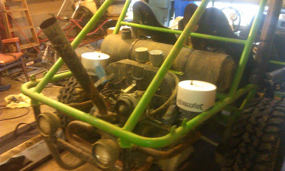

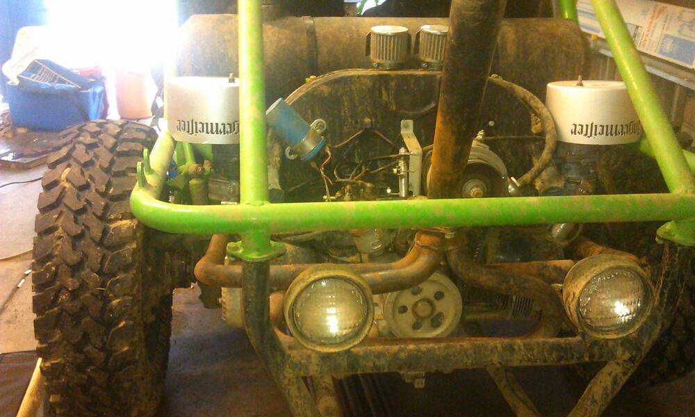

Made air cleaner covers for my kadrons. Cut up some jagermeiter ice buckets to fit what you guys think?

it's cool except the bolts on the top WILL leak water. Try to find a way to secure them at the bottom of the cover
PostPosted: Wed Jul 17, 2013 7:19 am
yeah I agree. the bolt pulls the cover down so water will pool in the center and slowly leak in. I just need to deal with these till I can come across a canister filter.

Rubber washer works. I have use to left over oil cooler washer . They seem to work out good.
PostPosted: Wed Jul 17, 2013 9:39 am
The old style faucet washers work really well for this kind of application. They are made from hard rubber and will not compress easyly.
PostPosted: Wed Jul 17, 2013 10:05 am
Ok ill try that. I also thought about smearing grease all over the nut and bolt.
