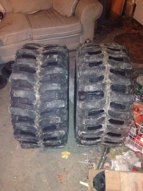

Wow that was a bitch but I got them done they look ok but I need a groover now
PostPosted: Thu Nov 28, 2013 8:27 pm
Let's see a pic
Yeah the cuts aren't the best I'm still a novice at this

PostPosted: Fri Nov 29, 2013 10:52 am
Oh ok. I've tried several kinds, Stanley for some reason cuts better. Good job
