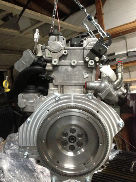

File comment: Shaun at AlphaFab Industries supplied the replacement; 2.4l Ecotec, Adapter, Flywheel, Wire harness & ECU with custom flash

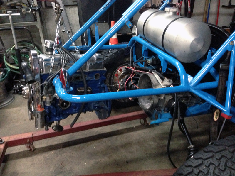

The Ford hung farther off back after being bolted to the trans, so the frame is going to need a little TLC to massage that LE5 in there. The Ecotec sitting more forward is a big plus tho, it will allows room to move the radiator behind the motor instead of blocking my rear vision since I plan on using this on the street a lot.

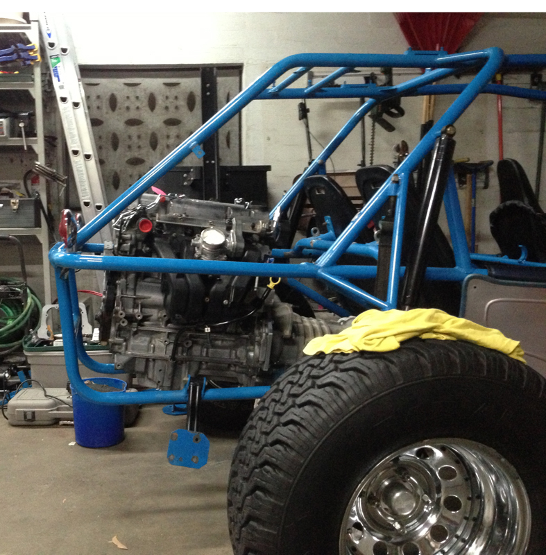

PostPosted: Tue Feb 11, 2014 12:28 pm

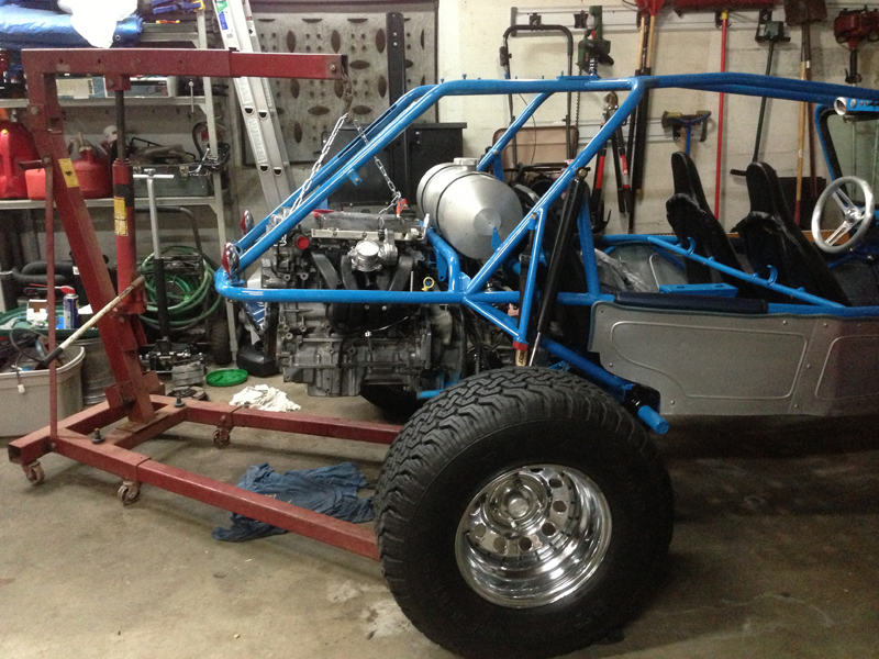

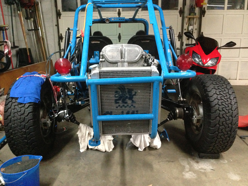

More room is needed to mount the radiator where I want it. Would also probably be a good idea to build a new rear motor cage to better fit radiator and fan.

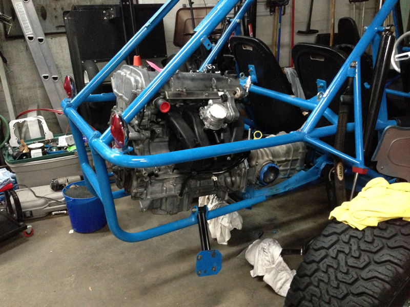

PostPosted: Tue Feb 11, 2014 12:34 pm

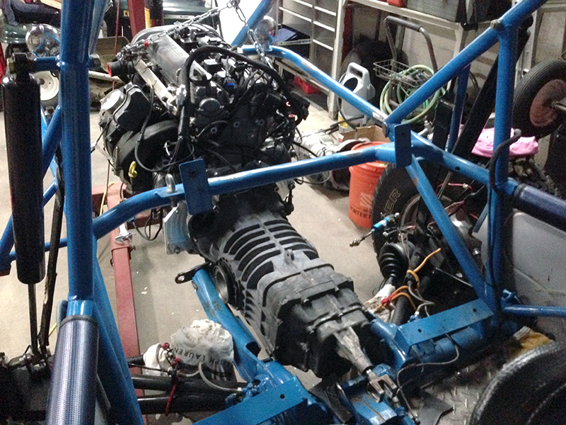

Motor now fits great with room to spare. Next on the list is chopping up all the existing mounts, sliding motor/trans as far forward as the frame horns will allow.

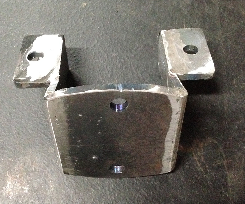

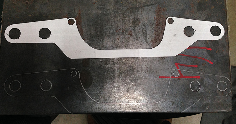

Finally got some time to finish making rear trans mount over the weekend.
File comment: Made the template on PC and used construction paper to transfer to 1/4" plate.

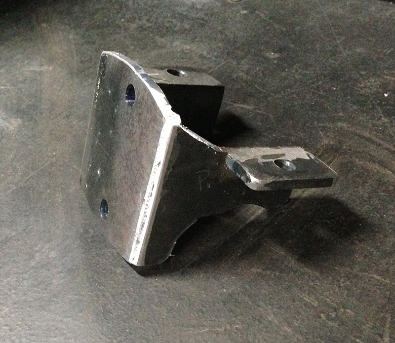

Finished fabricating the front trans mount using the same methods as the rear mount. 1/4" plate was overkill here but I already had it laying around. The two tabs on top are for the rear seat belts. Welding this sucker in there is going to be tight and tricky
File comment: The two tabs on top are for the rear seat belts.

PostPosted: Fri May 02, 2014 1:07 pm
Got the front trans mount welded in there and motor/trans mounted and finally hanging on its own. Gave the motor lift a long overdue break. LOL Motor sits exactly how I want it now - on the same plane as the bars - about 3°. Dropping from 10° to 3° also relieved some of the axle angle. Underneath the pan is still higher then the trans. Couldnt be happier.
File comment: Engine sits nice and even with bars at 3° - with old mounts it was 10° and kicked way up in the air.
