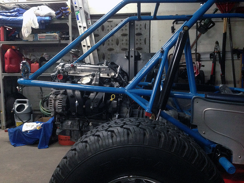

PostPosted: Tue Feb 11, 2014 12:34 pm
Motor now fits great with room to spare. Next on the list is chopping up all the existing mounts, sliding motor/trans as far forward as the frame horns will allow.

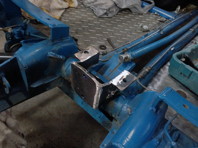

PostPosted: Tue Apr 29, 2014 1:08 pm
Finally got some time to finish making rear trans mount over the weekend.
File comment: Made the template on PC and used construction paper to transfer to 1/4" plate.
File comment: Test fit was perfect first go around.
