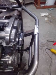

Been a little busy but I got back after it this weekend. Here are some pics of the rear cage and you can see the radiator hoses.

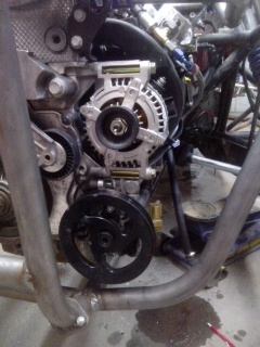

Alt and power steering pump

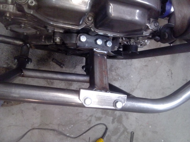

Rear engine mount

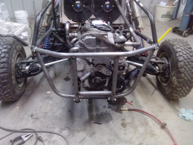

Another view

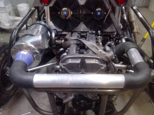

Air filter and intake

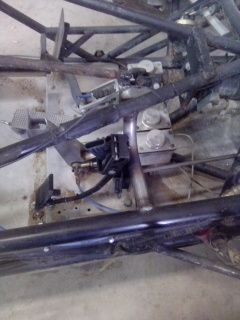

I enjoy seeing the creativity some come up with when mounting the DBW Accelerator Petal. Any pics? BTW, its coming along nicely!

Here is a pic of the accelerator pedal. I will try to take a better one this weekend.

Looks good. But 1 piece of advice the less 90's on the intake the more power. I just have 2 and planning on getting rid of them. May not be as big of a deal n/a but sc huge difference on the dyno I made 15 more hp by just taking the end cap off of the same filter housing. Just trying to help the straighter and colder the better

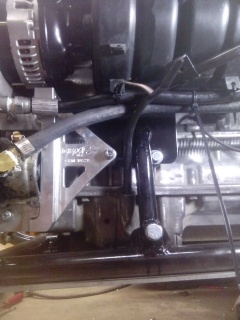

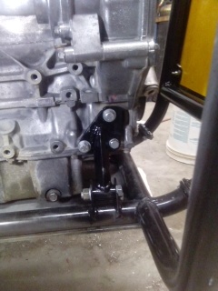

Well I am 90% put back together, I am waiting on I hope the last parts order with all my oil lines and AN fitting should be here tomorrow. I did decide to change my rear engine mount, It would have probably worked fine in a woods buggy but in the race world your rear cage gets a little love every once in a while. I didn't want that mount shoved through the engine block when a Trophy truck hits meet at 80.
PostPosted: Wed Apr 23, 2014 11:26 am
Posts: 80
Drivers side mount was a little tight on space with the header.
PostPosted: Wed Apr 23, 2014 11:30 am
Posts: 80
Passenger side a little tuff see with the intake. Hopefully I will be able to get after it this weekend.
