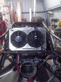

Radiator is in and fan shroud is built.

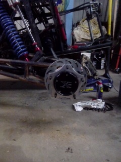

New micro stub kits in and one new axle and cv's. Alpha fab ecotec will be here Friday!

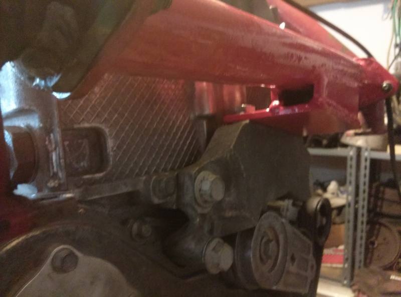

Here's how I used the stock mount
Mine is about the same but I bent the first it was 1/4 now its 3/8
