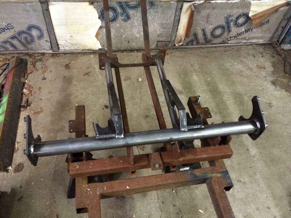

I am building a 2 seat buggy. I have plenty of pictures but apparently they are too large. maybe I can figure out how to make them smaller this weekend and get them posted . I made the bender from pro tools plans and made half of the die as well ( much to my buddies dismay i broke down and purchased the bottom follower die). . I am using a borrowed frame jig and i purchased a Fabricated torsion from tony ( he does outstanding work )
so I am planning on a 6rib and saturn power so we will see how it goes

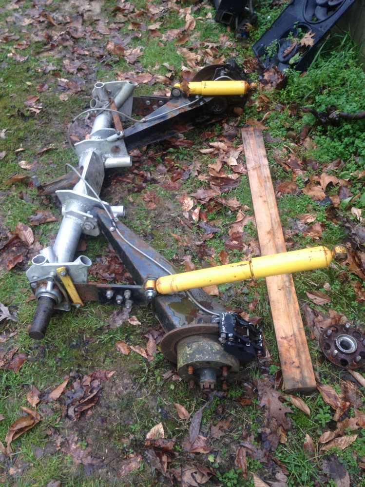

Photos....
parts that followed me home a couple of years ago

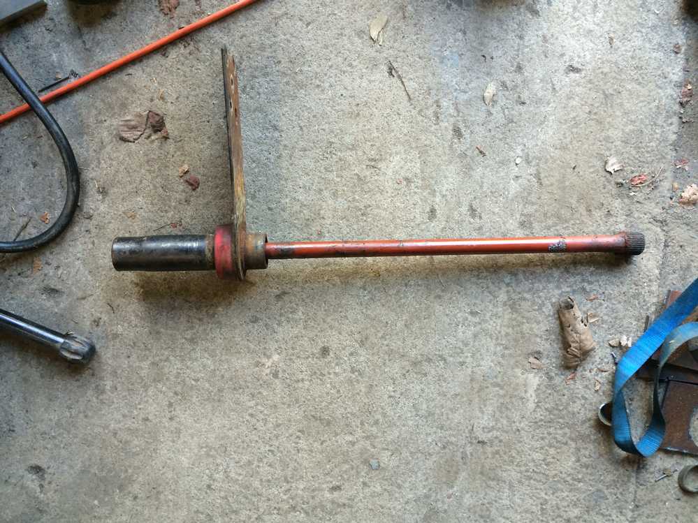

I tore down the parts torsion today (trailing arms,axles ect ) Still fitting the main rollbar (headbar maybe) the one with the compound bends. After that one gets welded in things will go much faster as almost everything else welds out from there.

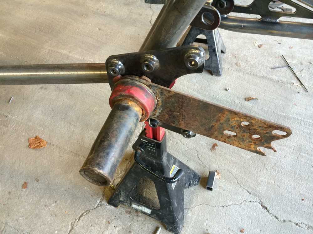

PostPosted: Thu Nov 20, 2014 11:05 pm
Location: Credo WV

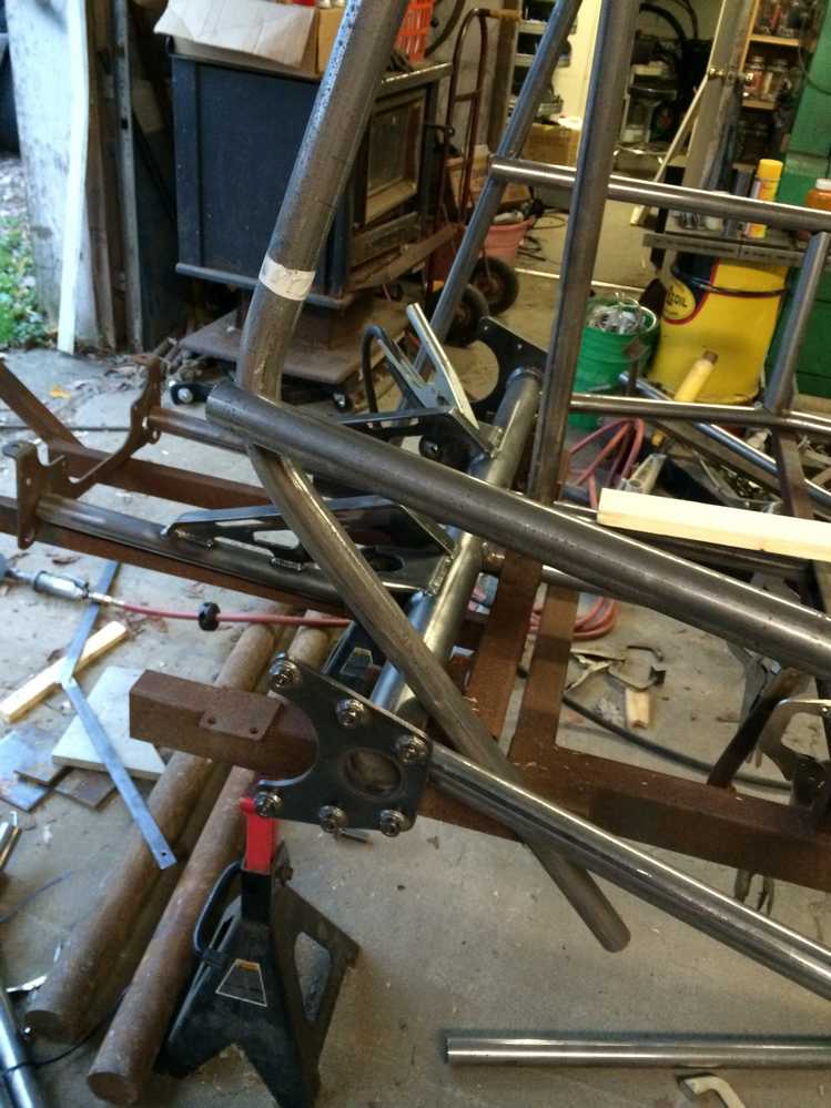

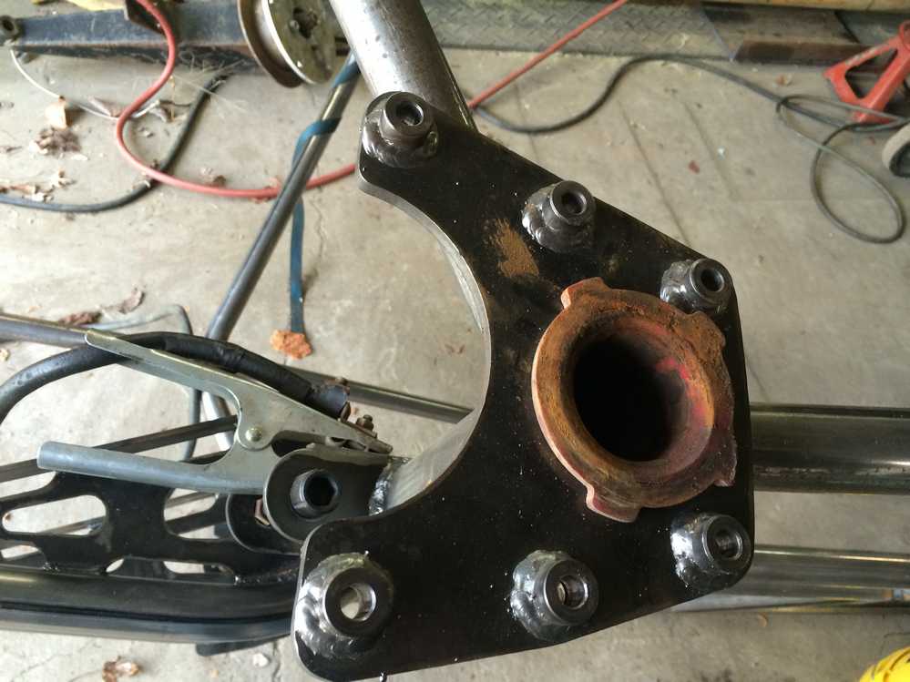

I found another descrepency or oh sh-- moment today. The rubber bushings that fit a stock torsion do not fit the fabricated ones.
on a brighter note the headbar was tacked in place today. bending the rear bar is next.

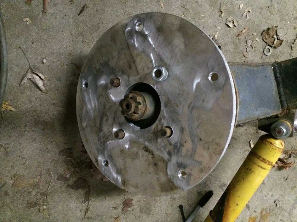

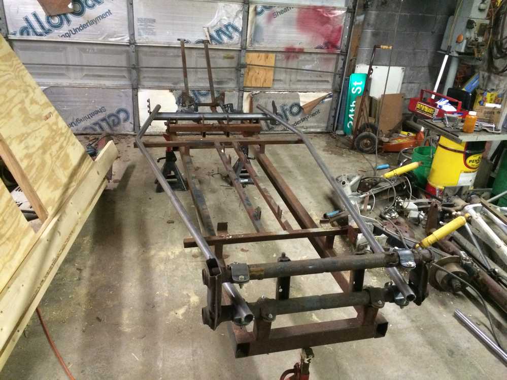

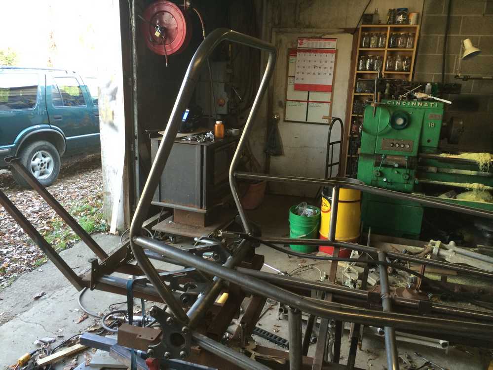

A milestone was achieved today. The chassis is coming off the jig. The biggest challenge of the day was finding the missing push broom. I am going to assume that it will show up tomorrow.
archie

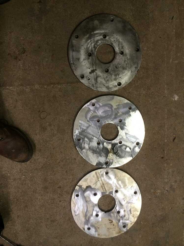

the frame jig was borrowed from a friend, this jig was made using an existing frame. it is really funny it has a setting for a 4 seat frame and the torsion is only like 10 inches further away from the front axle.

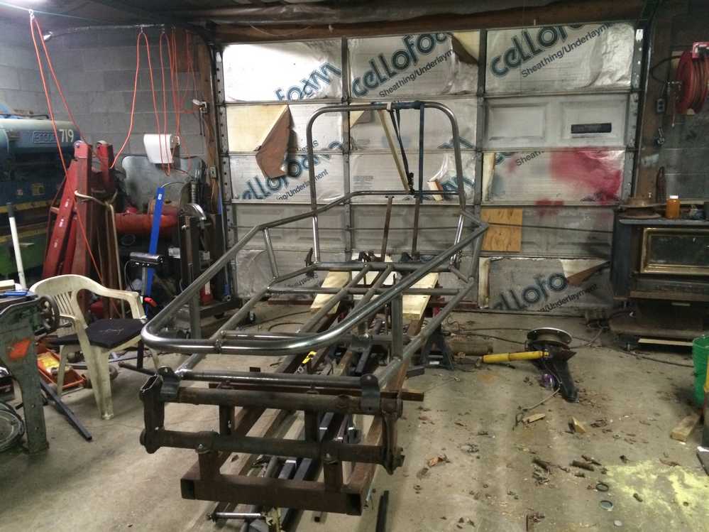

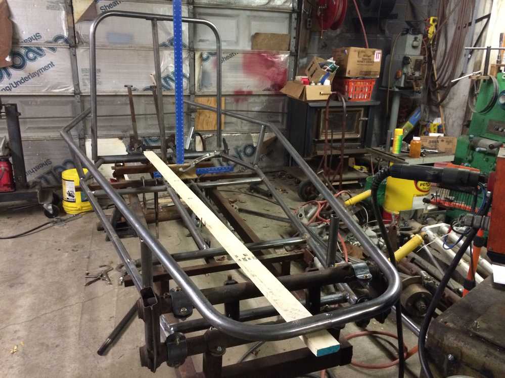

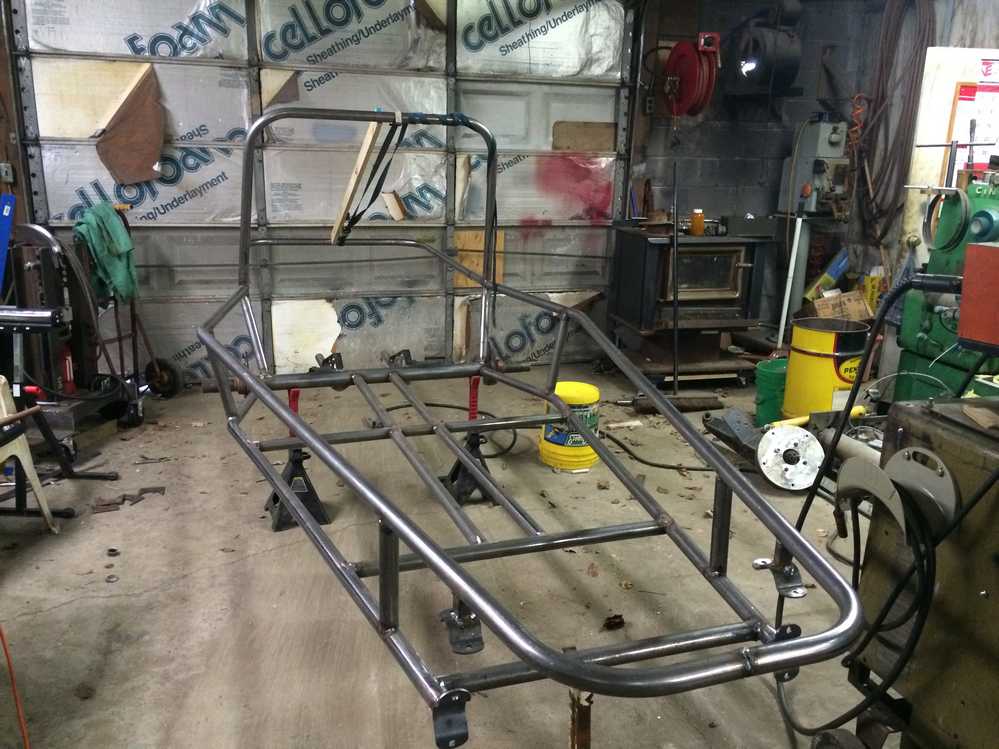

Today the frame came off the jig. (it was returned today as MY shop is full inside and it is in town so no outside storage) I started welding on the bottom side. I will bend the rest of the hoops soon and it will look more like a buggy. For some reason I have been having trouble getting the 1" tubing for the bracing (no stock)
Happy Hunting
archie

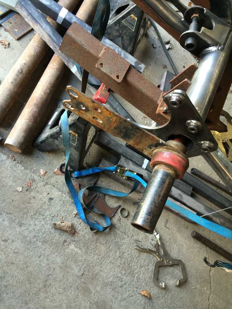

PostPosted: Mon Nov 24, 2014 11:47 pm
Location: Credo WV

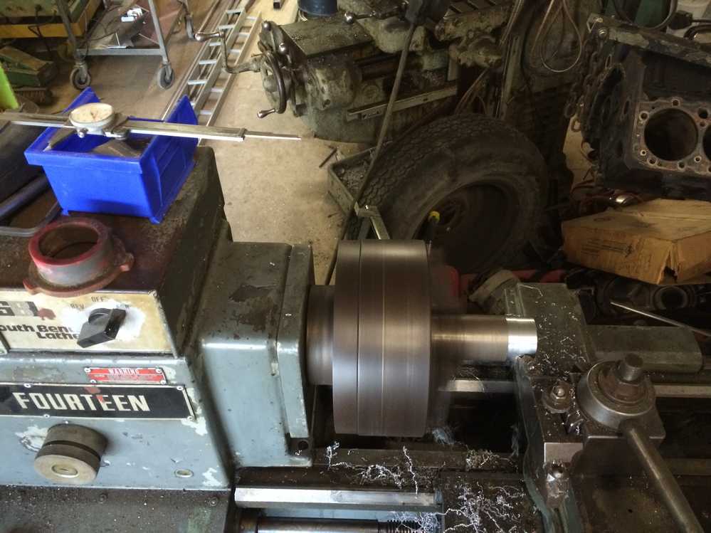

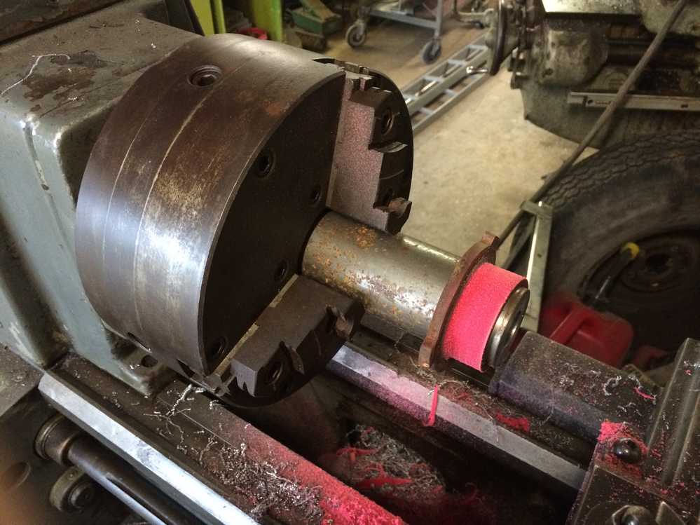

Monday,

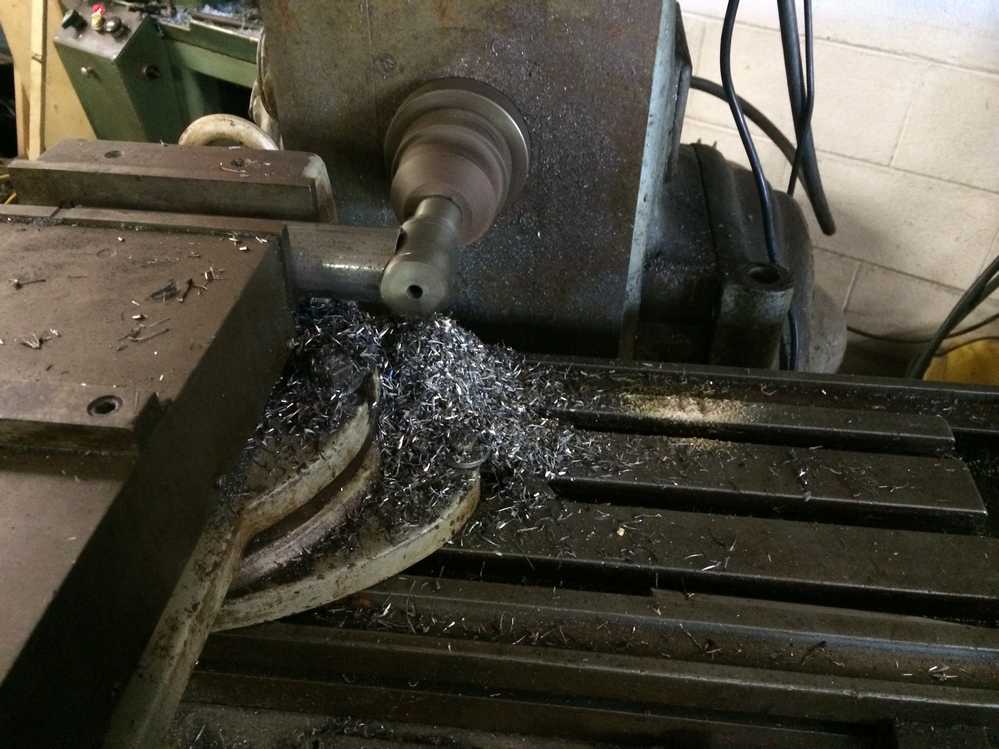

not a lot accomplished this evening. after checking around it seem that the answer to the plastic that fits inside the fabricated torsion housings are made of un-obtanium and in order to fit, the aftermarket bushings would have to be turned down on a lathe. it just so happen I have one of those apparatuses. So after turning a device to turn the plastic with. they were fitted to the torsion.

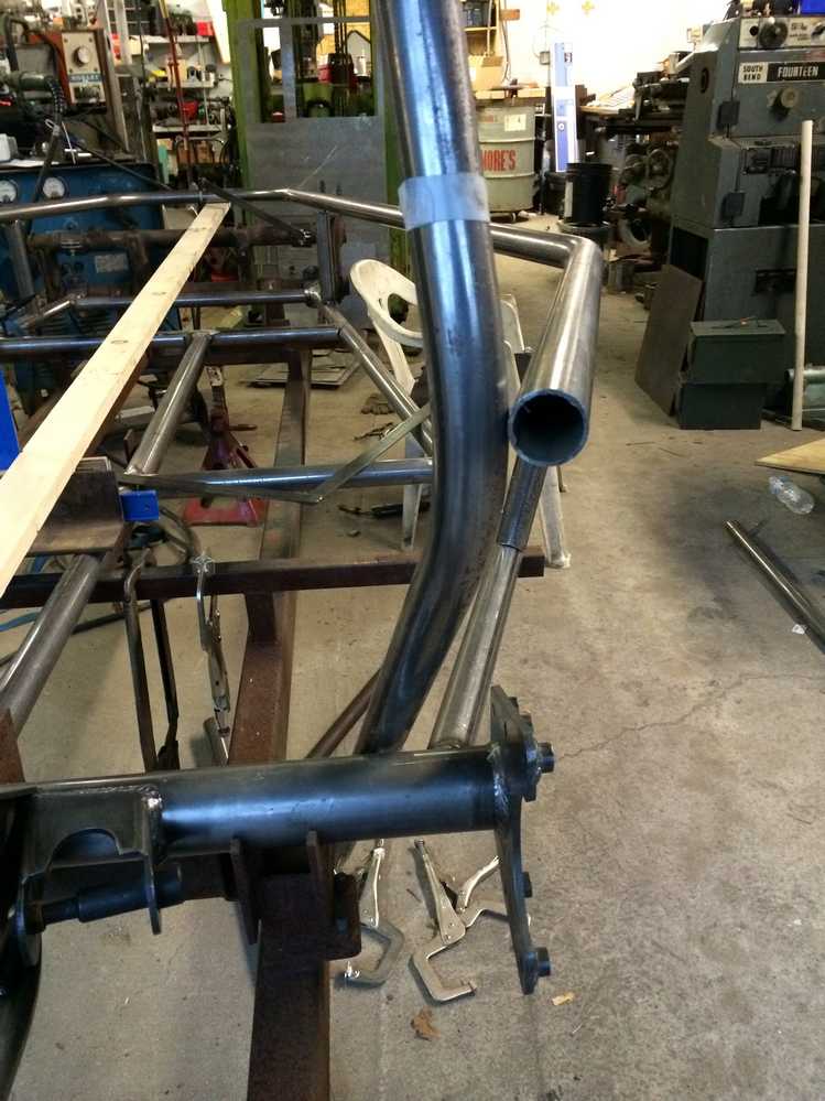

I bent the double headbar last night and tacked in a couple of the spreader bars. Hopefully tonight I can get the second headbar fitted and tacked in place.

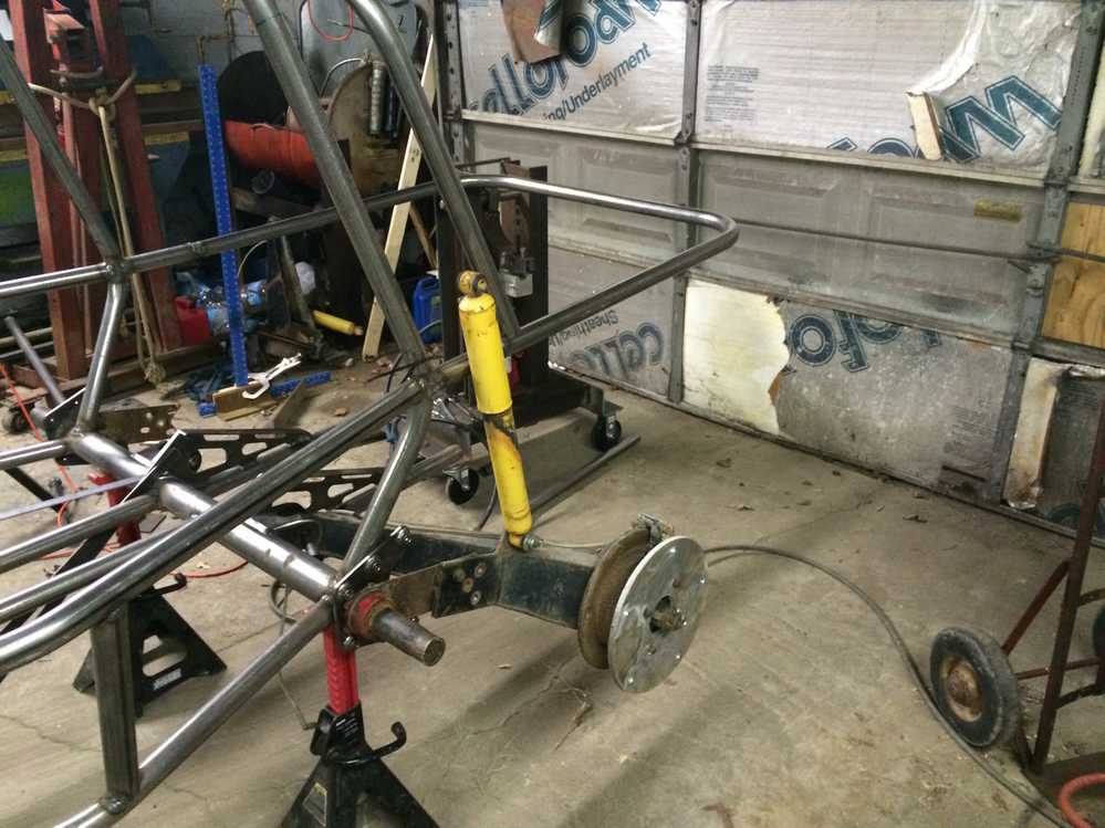

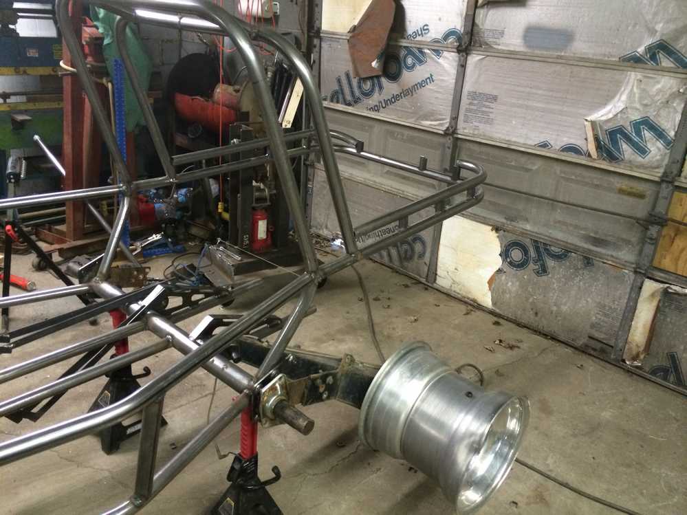

on a lighter note here is a photo of the rear trailing arm mocked up. some adjustments to be made but all il all pretty good.

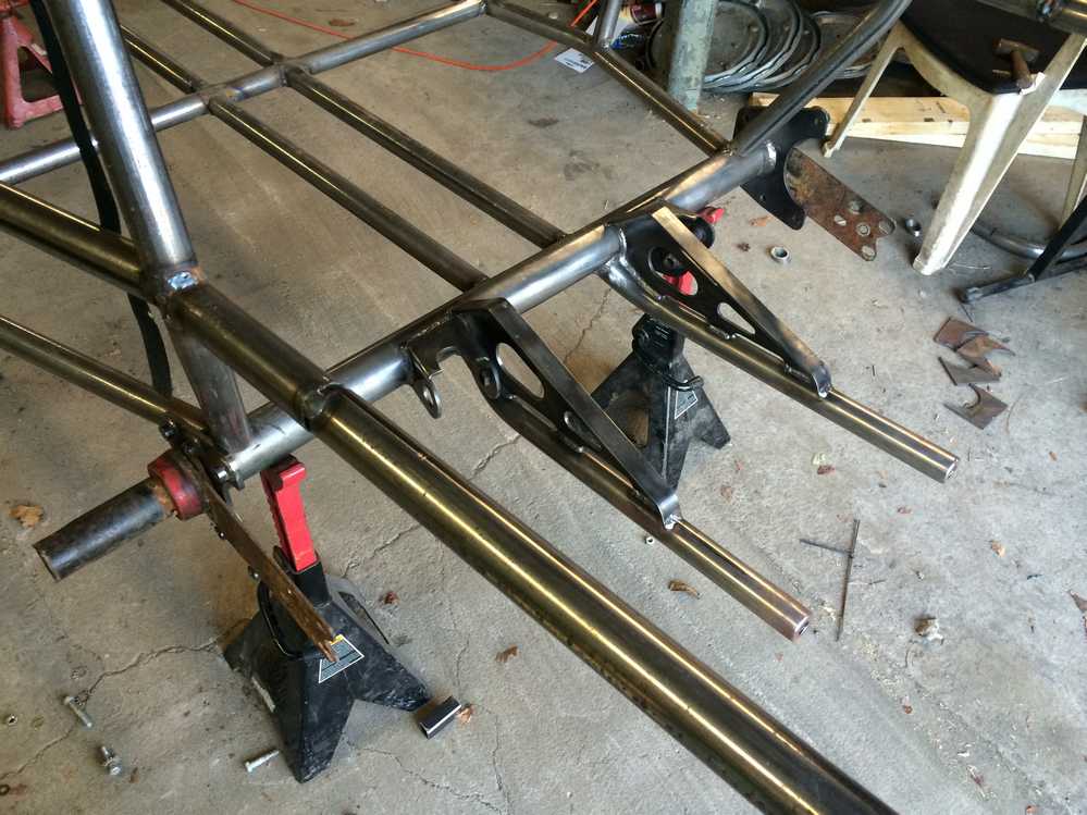

PostPosted: Sun Nov 30, 2014 7:44 pm
Location: Credo WV
Today's update
archie

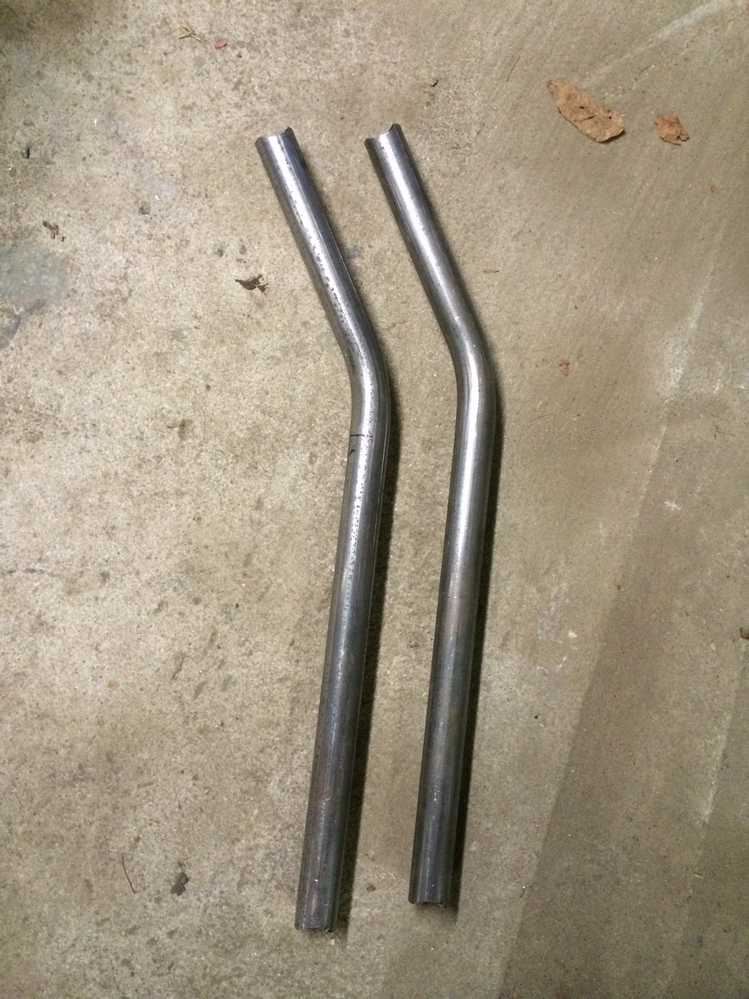

I bent and birdsmouthed the overhead bars and bent the windshield bar tonight hopefully I will get them fitted and tacked in tomorrow evening
Happy Hunting
archie
