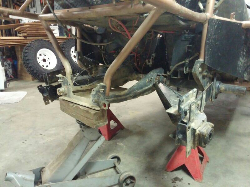

Got most stuff off of my rear trailing arms. Preparing for Mike's arms.

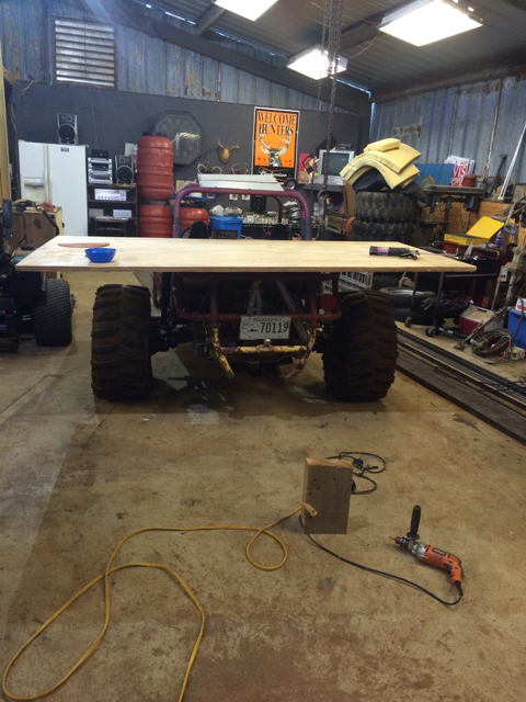

Used my buggy for a table. Wife project!!![POUTING FACE][POUTING FACE][POUTING FACE]

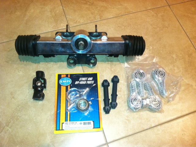

got a few goodies today now just have to wait for better weather to install

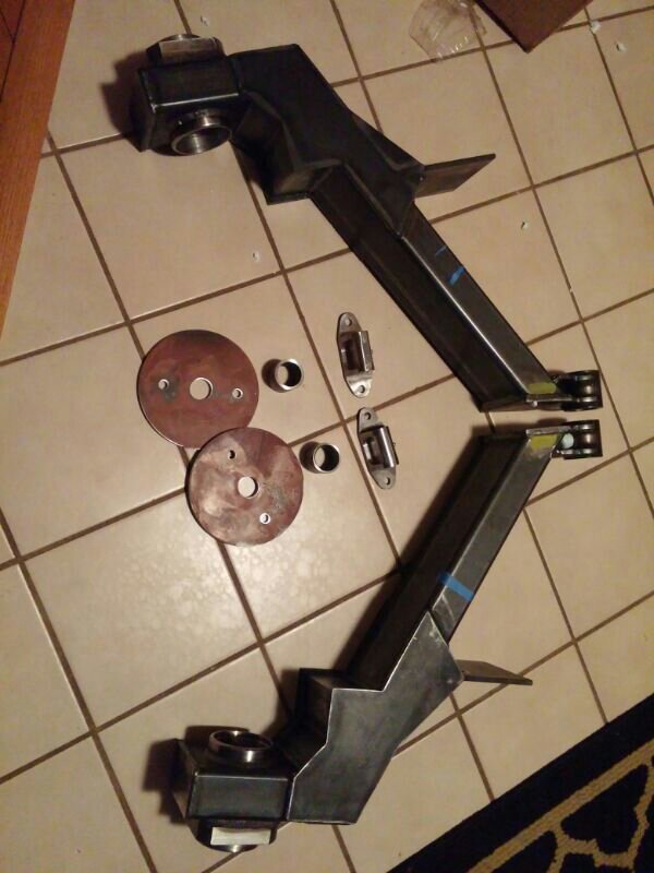

I love goodies. Here's my goodies I got this week.

hey, did you get your bag mounts from Mike too
PostPosted: Sat Feb 28, 2015 5:14 pm
Yes

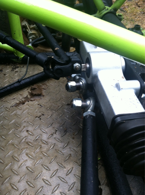

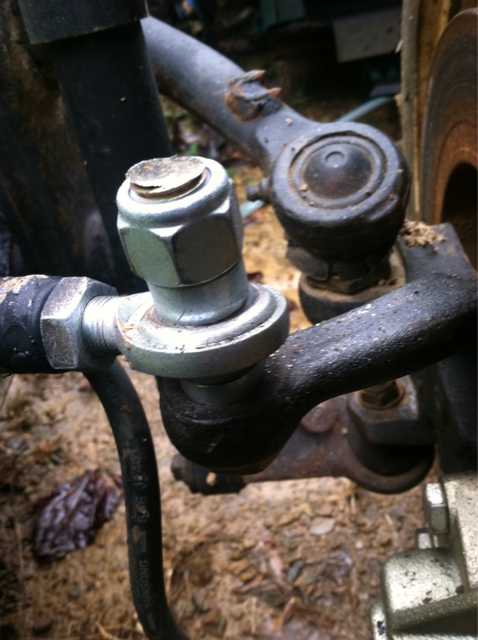

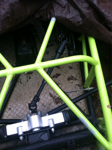

Got the rack and pinion with heim joints installed

I think your missing the high misalignment spacers on all those heims , you gotta buy them separate then the heims. 2 per heim if not they will probably bind up and you will be pissed if you ruin them.
PostPosted: Sat Mar 14, 2015 7:51 pm
Are those homemade spacers or just different looking ones then what I'm used to

They are home made spacers
