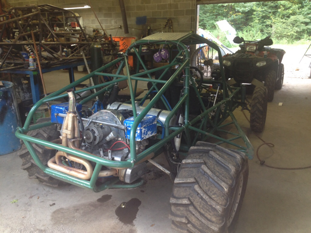

PostPosted: Sat Dec 06, 2014 7:11 pm
I'll sell u mine and save u a lot of time and money.
PostPosted: Sat Dec 06, 2014 7:25 pm
Posts: 79
Location: fairland, in
I remember trying to make my list.... I had everything on my list and about 50 other things that were not on it sitting on the table at Gary Davis's shop and i still had to go back multiple times for things I forgot. I have about 4500 in my buggy and its just got drums with no cutters and a stock pedal assembly. I am dropping about another 700 on it this winter for breaks tubing and a carb. But no matter how much money I put in it I dont regret it because I love my buggy. Its an addiction. Good luck on your build, youl love it.
