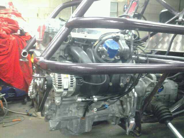

I bolted the motor in the buggy
Sent from my SM-G900V using Tapatalk
PostPosted: Wed Jul 23, 2014 3:52 am

Looks sweet man :mrgreen: Cant wait to start my ecotech swap. Im so ready :mrgreen: :mrgreen:

Looks good Darrell ,do you have to change the bars over the motor or will it work?

Everything is gonna work Mike ....Under carriage won't work the oil pan sits a little lower than the VW but hell i can deal with that ....i got lucky

Just keep the oilpan off the skidpan. I've busted one already
PostPosted: Wed Jul 23, 2014 6:03 pm
Looks good . How long and how tall is the engine ?

Its about this big!!!!!:mrgreen:wiring this was sweet with the way they label everything. Definately a good setup!

Just tossing something out there but couldn't you raise the back of the trans up some, just enough to not need to redo your under bars and skid pan. It would also improve your departure angle so less banging at the rear of the cage. Doing this is a little more than just jacking up the back of the trans but it might be worth looking into. If I recall correctly I pitched up my trans about 8 degrees lifting the motor up a couple of inches.
Just thinking out loud.
An old semi truck mudflap cut to fit between the oil pan and skid-plate seems to help alot.
