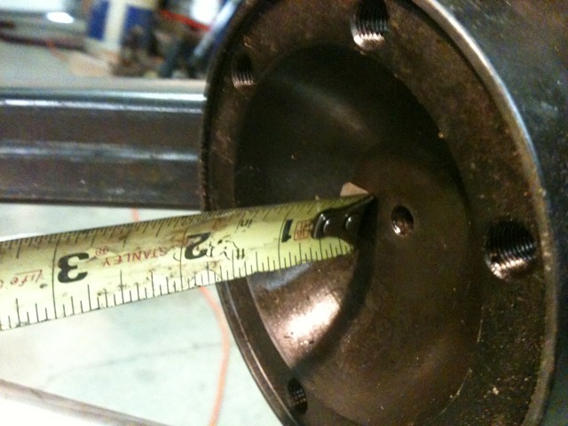

You want to measure it with them level to each other. Mine measured 17 1/4 minus a 1/4 equaled 17" axles.

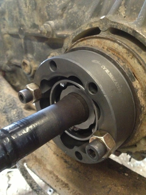

Yeah with them level to each other I got 17-1/2" take a 1/4 of that an il have a 17-1/4 axle. I took a stock bug axle and turned the c clip grove out some so I could get a clip on the trany side with a bus cv an it looks a little long to me but I'm Gona run it an see what happens. Hears a pic with the axle pushed all the way to the wheel side.

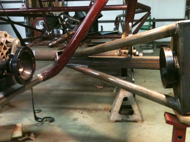

BTW: Mine is a totally custom set up so my length will not be comparable to any VW set up.
If you have axle and cv's installed, level it all up and as long as the axle doesn't bind and you have some side to side play you should be good...

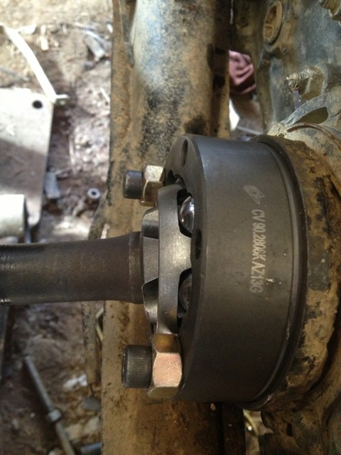

Here's a pick at full droop
