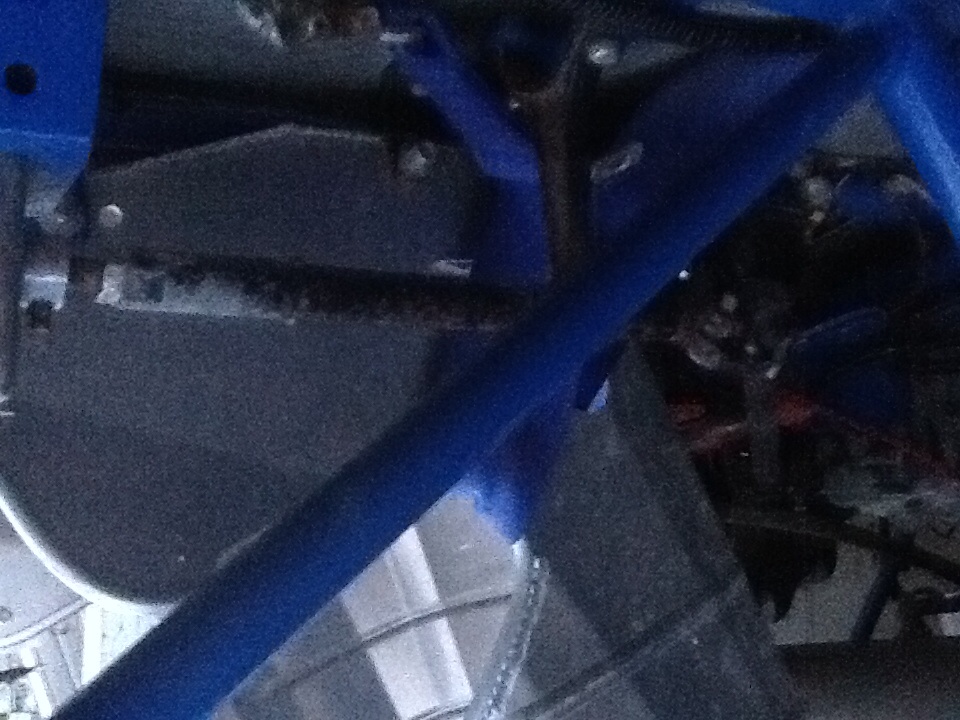

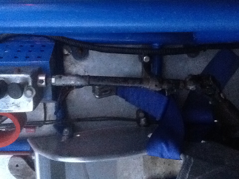

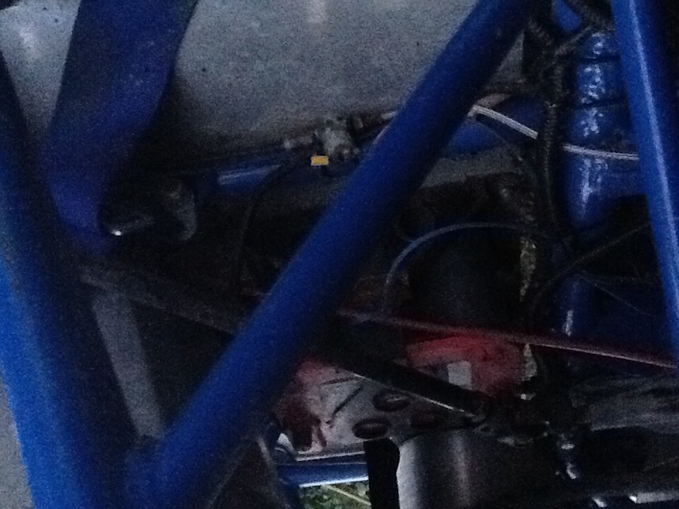

Two cheap ujoints and a used connecting rod. Works great. Chad :mrgreen:
