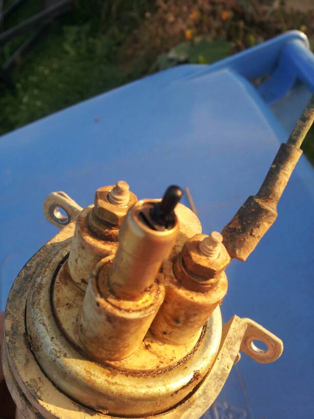

Im running the chep summit efi pump. I had to pull it out and found this rubber sticking out the end it runs fine but it was not there before im going to swap it out. Anyone have any ideas what it is or why with would happen?

has to be something from inside the pump because if in went through the pump you would of heard it.

How about one of these http://www.megamanual.com/v22manual/minj.htm#supply

Thanks thats what I was looking for

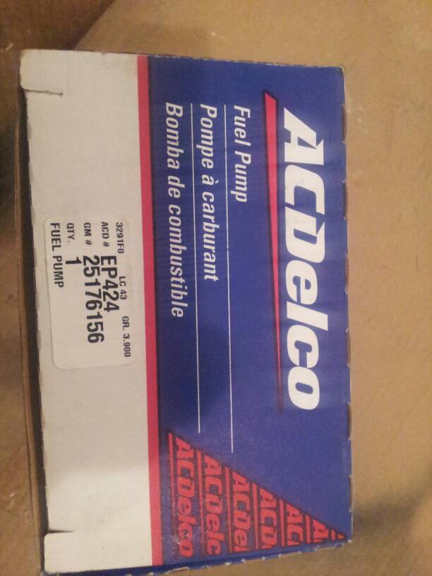

Here is what im running now. I picked up off ebay as NOS for 38 shipped. If anyone is looking for a quiet pump this is the one to get. It makes NO sound at all.
