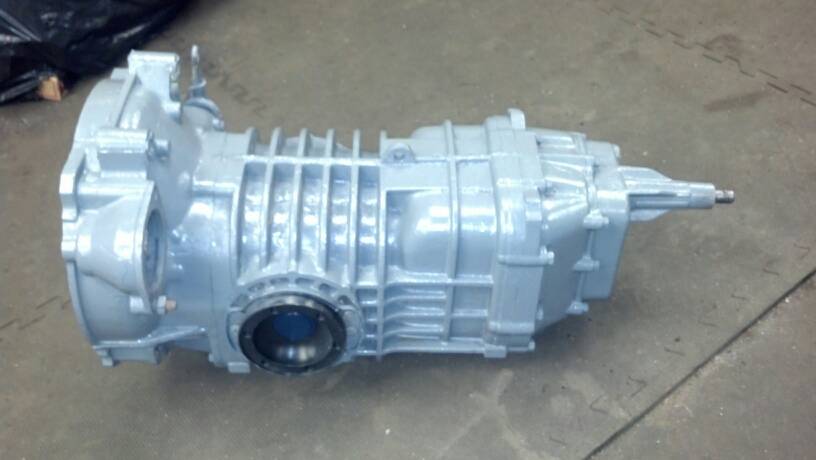

A little bit more done today . Torsion eliminators are done transmission just done by Chuck Jones
PostPosted: Thu Jan 30, 2014 9:52 pm
Looking great Darrell what did you have Chuck do the trans
PostPosted: Fri Jan 31, 2014 12:12 am
Had him change the gearing . Changed first and second gears

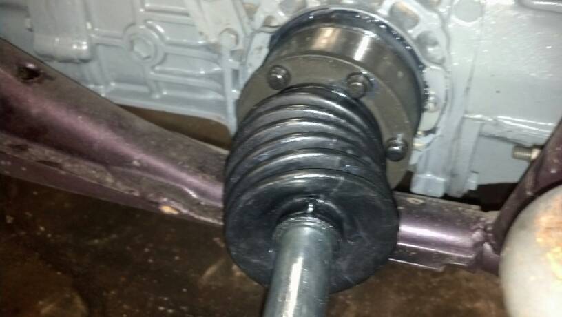

PostPosted: Sun Feb 02, 2014 8:44 pm
Motor and transmission is back in new 930 CVS new axles

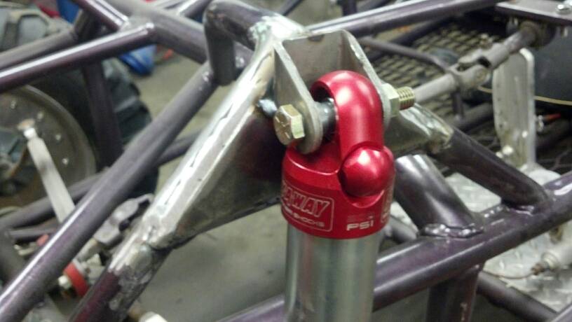

PostPosted: Tue Feb 25, 2014 12:04 am

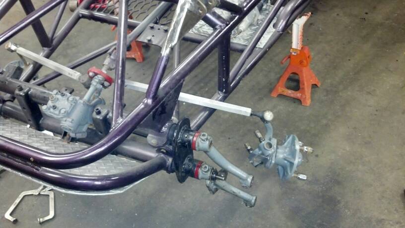

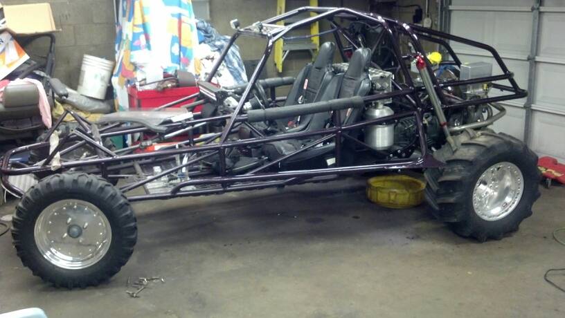

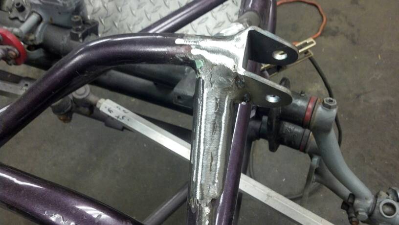

Well I got the rear finished shocks are on limit straps are welded in place motor and transmission is back in.... Painted. Now I'm moving on putting the shocks on the front what I thought was going to be easy job is turning into a nightmare as usual . I have got a link pin front beam I am putting through rod in and putting the arms back on I thought. One arm is fitting really loose so I am trying to figure out a quick fix for this I know they make they make A polyurethane bushing I'm thinking. The problem is its the inner bushing anybody ever had a problem and what is the fix ???
PostPosted: Tue Feb 25, 2014 12:47 am
Posts: 3891
Might want to brace the mount a little more. I assume you don't have torsion springs so that gets a lot of torque on a jump. Just my $0.02 a couple of little triangles up to the frame may save some repairs. But then I've spent to much time with Odyknuck and Plumberbill to not go "Captain overkill"!
If I recall, you put EFI in that buggy already didn't you? I'd think that would work better with the computerized nitrous system.
[/url]
PostPosted: Tue Feb 25, 2014 12:55 am
Yeah its a computerized nitrous system .... nitro welded a lot better then what the pictures actually shows I could definitely hit a few trees and it ain't going anywhere I hope lol. It would definitely take a roll over I know that for sure
PostPosted: Tue Feb 25, 2014 1:23 am
Posts: 3891
Well I side stepped into a tree and all the welds held great! Just ripped the 1.5 DOM to shreds. I could see it twisting that pipe, but it may just be me expecting the worse. Plus everywhere I ride is 3 hours or further away, so I hate to have things brake. Drove 9 hours to Black mountain, tranny broke ten feet up the first hill. That will piss you off! :mrgreen:
