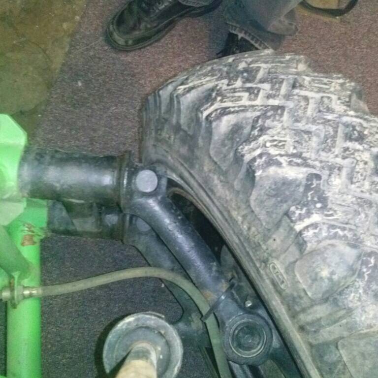

How is it possible you tire is rubbing your control arm? frame yes but control arm, can you post a picture?
 Post subject: Re: steering stop ideas?
PostPosted: Fri Jan 10, 2014 10:15 am
dave im not sure i understand what your saying. my alignment is right i did it with a machine at work. the problem is my tires rubbing at full turn both ways. rick i know it sounds crazy but my tire is rubbing the control arm where it pivots on the torsion. ill get a pic when i get home tonight and post it.

I could see on a wider beam that could happen, but my tires hit my frame before they get that close.

PostPosted: Fri Jan 10, 2014 9:16 pm

Wrong offset wheels?
PostPosted: Fri Jan 10, 2014 9:40 pm
hmmm? yeh a different off set wheel would fix it. do you have stock vw wheels on the front?
PostPosted: Fri Jan 10, 2014 10:02 pm
Flip your rims inside out and no steering stop needed :)

run smaller tires. Do NOT flip your wheels inside out unless you don't value your fingers or wrists anymore.
PostPosted: Sun Jan 12, 2014 3:49 pm
last thing I want to do is run smaller tires. these are only 6.00-15. I agree with saving my fingers which is why im still debating getting the spacers off mike.
PostPosted: Sun Jan 12, 2014 7:07 pm
Even a 1/2" spacer is going to cause some very minor steering changes and are not the perfect fix. The best fix would be to change the offset in the wheel. Just how wide are the floor rails on your car hp ?
