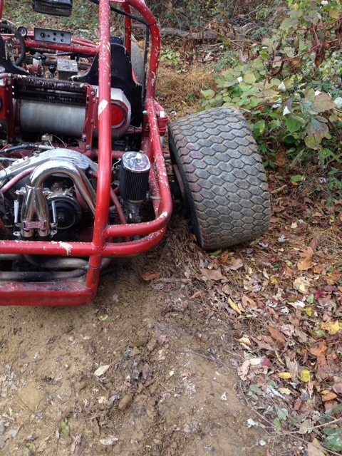

I'm looking for the outter half of a passenger side 2 piece rear bearing housing in a 72-79 type 2

we broke the same thing on my boys buggy. we welded in a bug torsion and solved the problem.

Them cast arms won't take it . Had a buddy break at least 3 .

I'm wondering if I can bolt the beetle trailing arms up to the bus torsion like if the spring plate bolt pattern is the same if not I guess I can just drill it out

No cause the bus arm is longer than the beetle arm

We'll that sucks guess I'll be doing some fab work

I'm running beetle arms now just going thru a world of shit to get em setup
