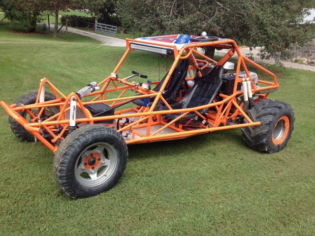

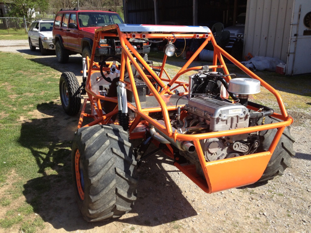

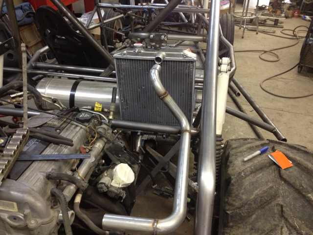

2013 tony Begly explorer chassis. Had some buggies 15-20yrs back, then got into 4-wheelers & side x sides. Then around fall of 13 decided to build a new buggy. But didn't want the issues of air cooled (sorry).
Stock front,w/ discs on separate pedal & Micky Thompson tires
2.2 ecotec stock except header
6-rib stock
2x3 arms & discs
Cnc pedals & cutters
Alum rad for a Honda Civic
Late model wheels w/ 15.5 v-treads
F-150 fuel pump & filter
30" LED bar
Pyle water proof amp & speakers for iPod-iPhone
Viper 5000#waterproof winch
All fab work done by me with wiring help from friends.
Paint scheme from my boy(he's a bigger dukes of hazard fan than I was)
Rode first time weekend before Memorial Day & haven't had the first issue yet. Love this buggy
