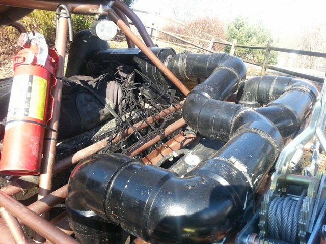

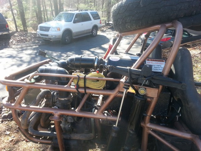

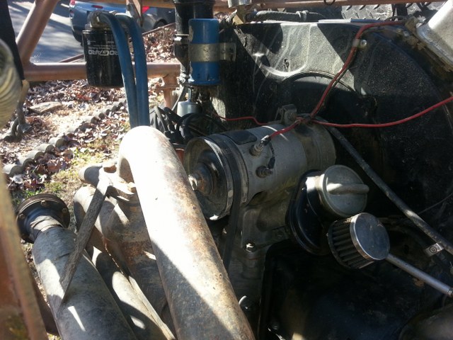

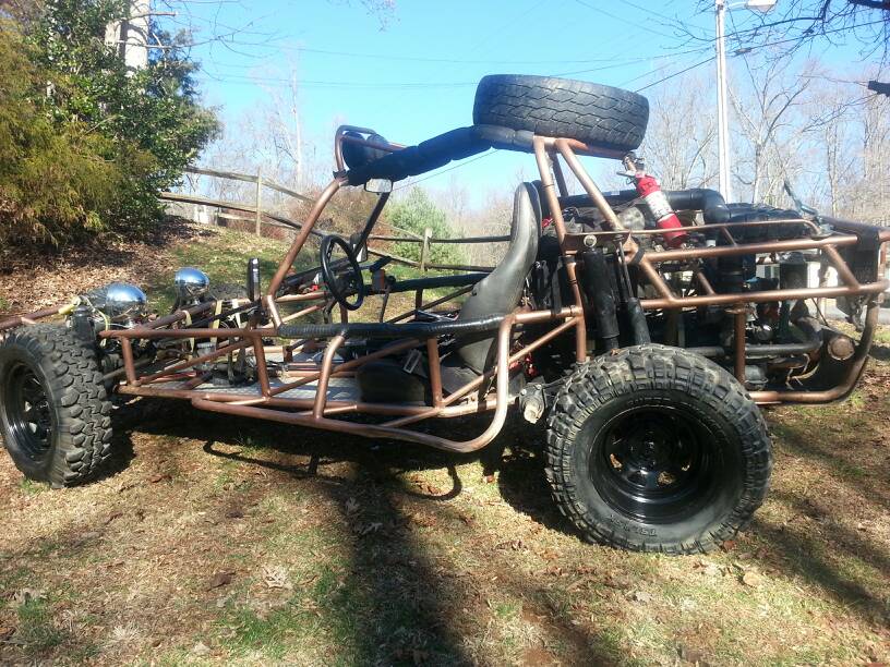

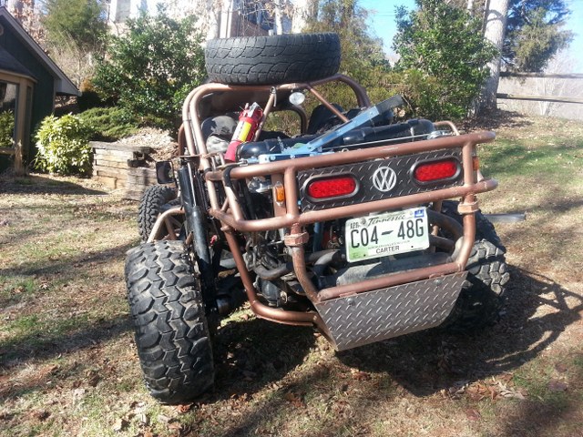

Here's my build. Its not fancy but it gets the job done. My first woods buggy was a Berrien Warrior built in 1984. I finished it in two weeks between school and my part time job. This one is my third and between being laid off and 30 yrs older it has taken me 2 yrs.
*The frame is a Warrior with truck bed option.
*It has a 1915 engine with dual Kadrons connected to an industrial breather.
*3 rib tranny with 930 cv's
*Nissan Sentra rear brakes
*CNC cutters
*Dual shocks in back, 1 emulsion and 1 air.
*Air shocks in front with custom towers.
*Seats are Jeep Tj
*6000lb winch with 8000 lb come a long
*Rack and Pinion steering from '95 Grand Am
*And 4 Swampers to make it go.

how does the front end ride with the air shocks on it?
 Post subject: Re: Big D's Trail Rig
PostPosted: Thu Jan 02, 2014 1:57 pm
Pretty smooth. I only have one set of torsion in it. I have thru rods on the uppers. At least I think its pretty smooth. I haven't rode in any ones buggy. Its smoother than factory.
