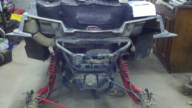

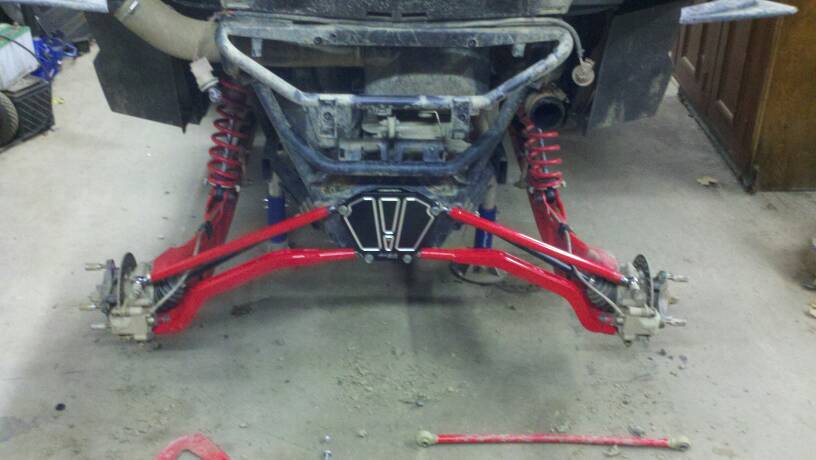

Just finished installing radius arm kit from Alba racing. As the alba bumper that's on the front the quality is top notch. I wish I could post a pic off the app
PostPosted: Sun Nov 10, 2013 8:17 am
Posts: 1461
Sweet, got the phone app working

Nice. Have you had issues with the OEM? Been considering them for the Wildcat. Looking at High Lifter or making my own. A couple of Heim's and a couple of bends in a tube.
PostPosted: Sun Nov 10, 2013 10:41 am
Posts: 1461
I bent a lower arm at the ville when dave and I were both in it. I also bent an upper when I rolled it. I started priceing the heims and spacers and the price of those were more than buying the kit with the tubes included. Sometimes its done for you cheaper than the time you would put into it. They are very heavy duty compared to the factory pieces. Alba really does nice work.
The average price for the Wildcat lower arched radius is $250.00.
I could make two sets for that much. :shock: The top straights can be made real easy with part's from Speedway motors. You can buy 1 1/8" diameter swedged aluminum tie rods in about any length for `15 to 20 bucks a piece. Good chromoly Heims for around the same price. Just sayin.
PostPosted: Sun Nov 10, 2013 7:04 pm
Posts: 1461
Speedway is where I priced the hiems and spacers. It was almost 200 for them, plus the bars. I paid 249 for the alba kit delivered to the door. Couldn't beat the price

Yes, I bought the kit with billet center support.
The kit without the center piece is 249 shipped, 279 with it.

Ok that clears that up. I was thinking it was the lower arms only. Your right it's not worth building at that price. Just the lowers for the Wildcat are close to that price.

After a lot of research those are the same ones I bought. Ive bent many lowers. I even bent a lower at the sand track at hillsville just from hitting the corners hard and fast! Side note, Alba doesnt make them though..
