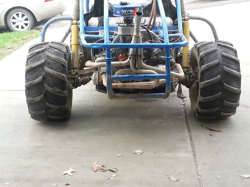

well after what seems like years and 18 pounds of rubber in my eyes i got 1 tire done as im doin! the one on the left of this pic. these outta hook pretty damn good. this is alot of workImage

Got to open the left centres up alittle still

DO WHAT :shock: these tires have no center when there a 60/40 cut! you open up the centers to make the tire softer. and believe me these tires are soft as a babys ass! they are ground down smooth to as close to the cords i could get without seeing them everywhere. ihave a set 50/50 on my buggy, and im pretty sure these are gonna walk all over them

I was talking about mine lol look at the pic lol
