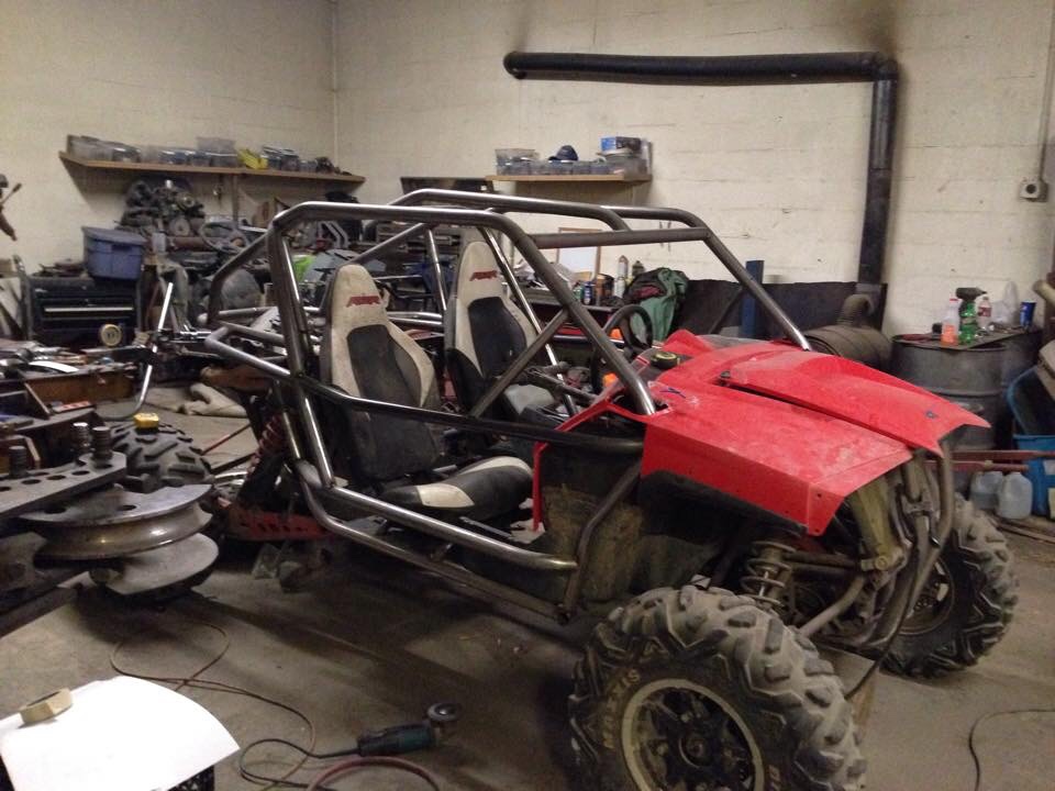

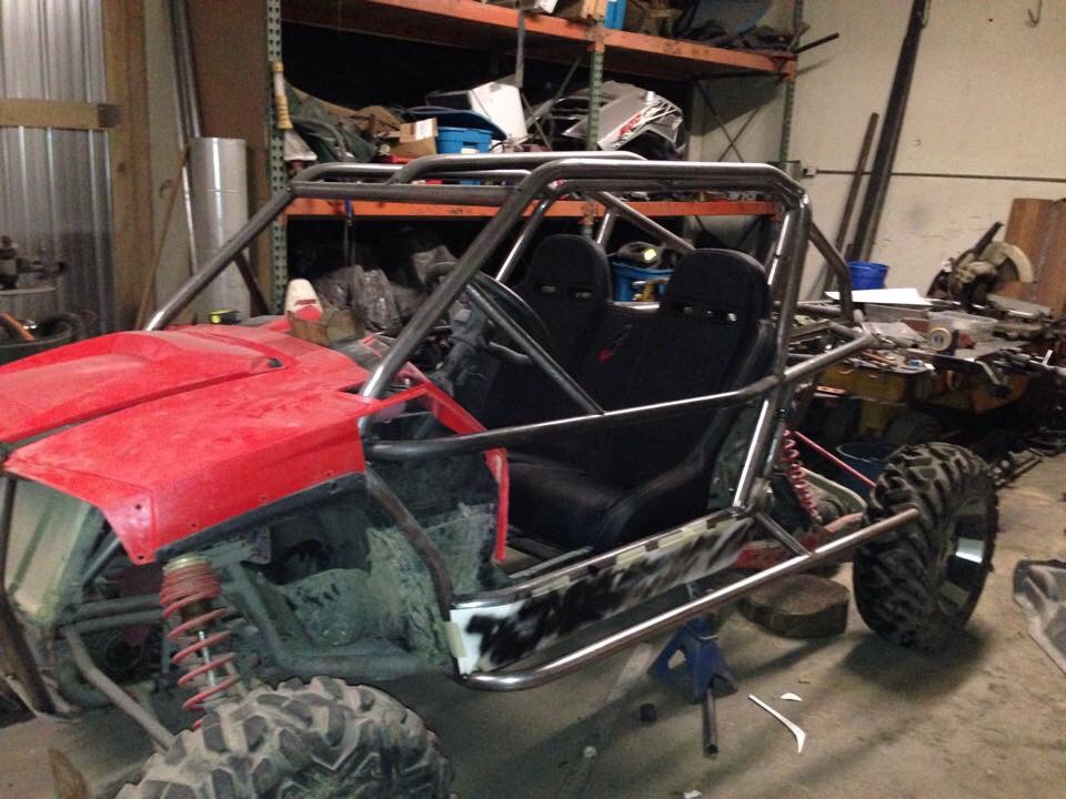

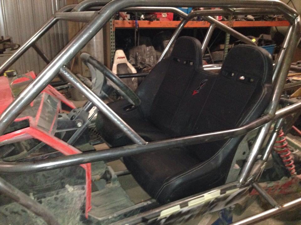

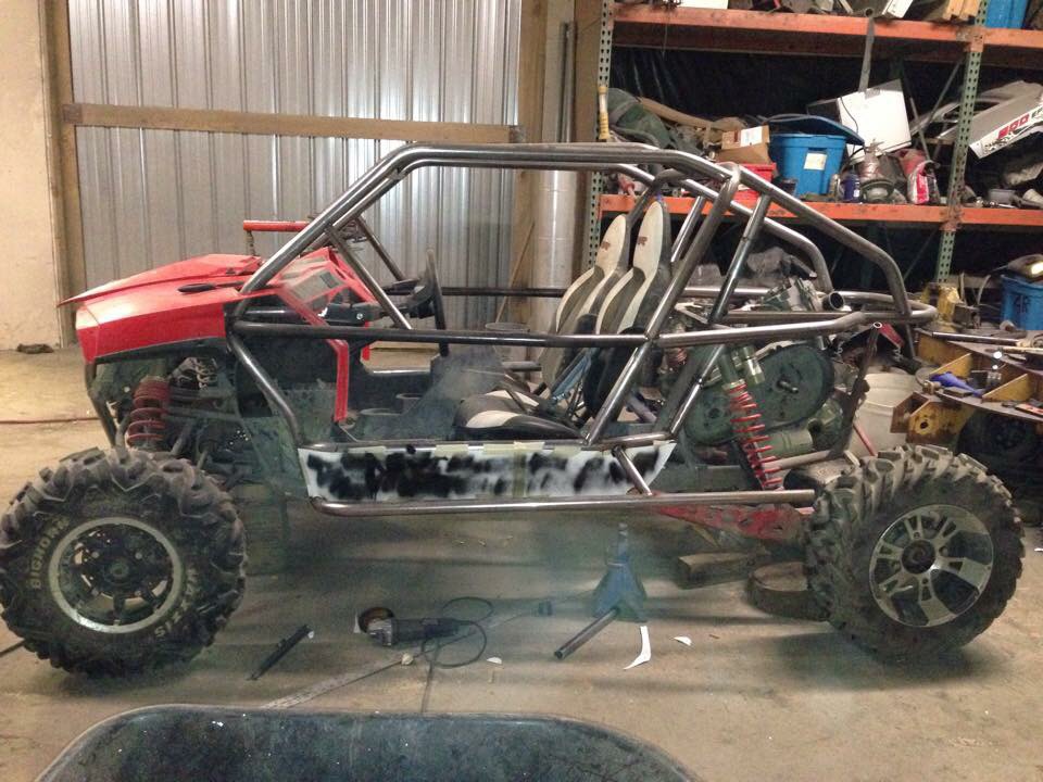

Looks great willie
PostPosted: Thu Feb 05, 2015 1:12 pm

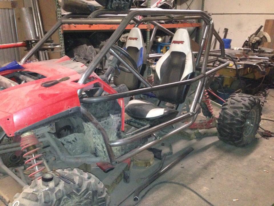

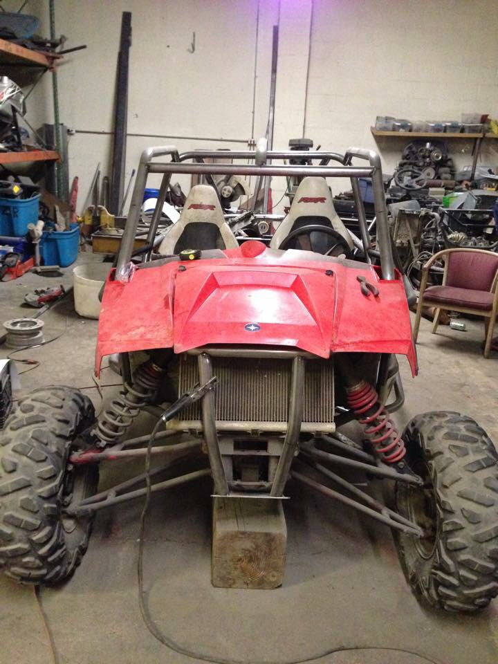

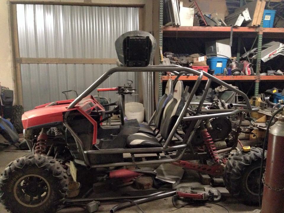

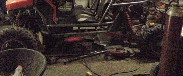

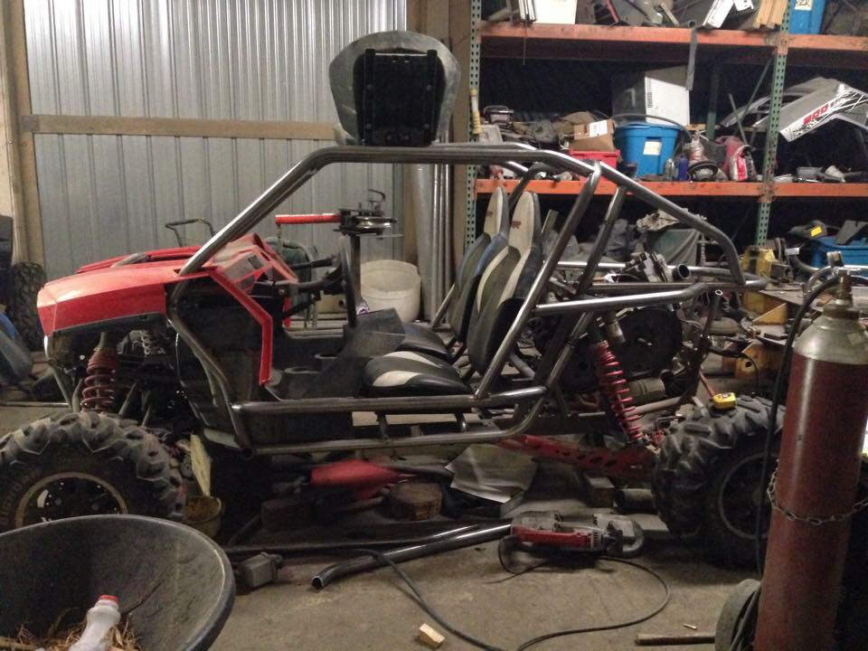

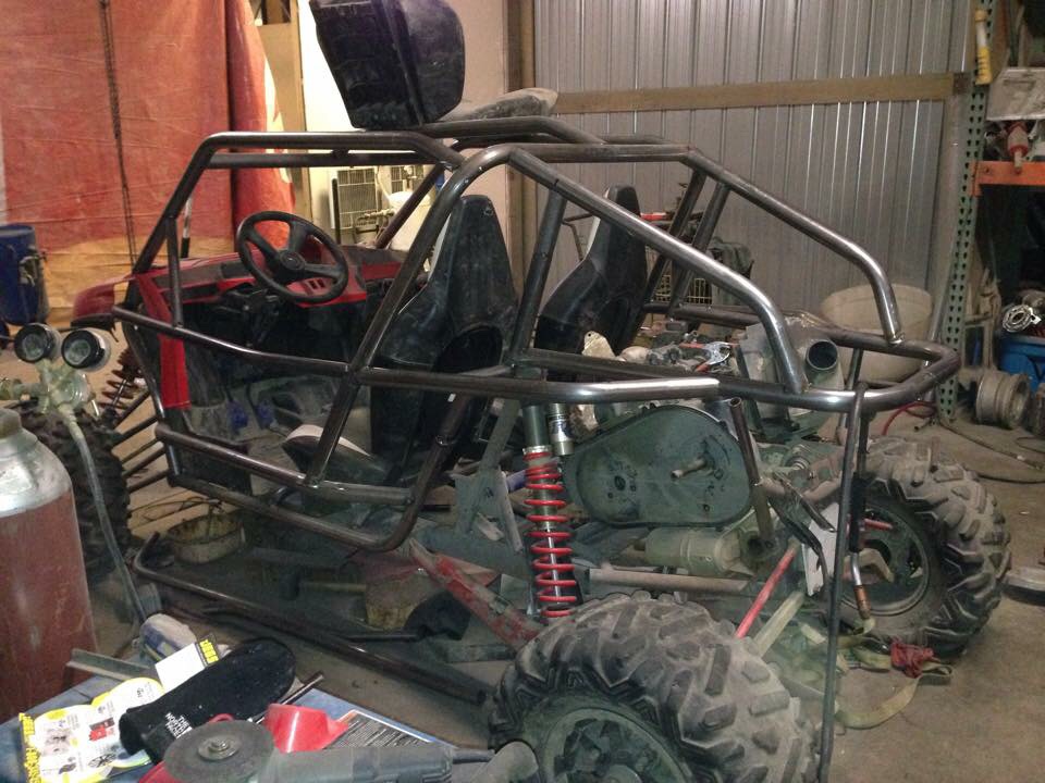

looks nice! What size/wall thickness tubing are you using?

095" 1.5 and 083 1.75. But I've got it braised up good and I'm hoping for it to be around 1000-1100 lbs

I hoping this will get me back in the click with my buggy buddy's so we can have some more good times and climb some killer hills again !!!! I'm not building this thing to be a mini rock bouncer this is going to be my idea of what a woodsrzr should be .. I loved my buggy and had a great time with some awesome ppl and a ton of friends but I also have a good time riding sxs and can't afford both so I hope this turns out like I plain !!!!!!!
