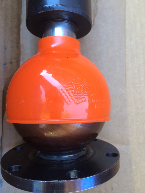

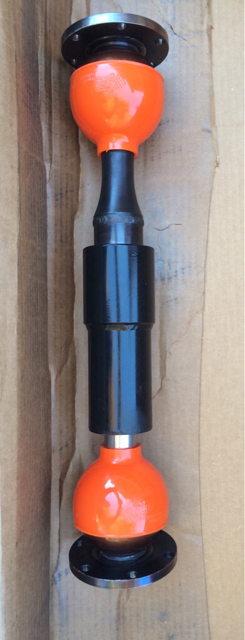

I received the new axles today.
They are very cool. I really like the spherical boot. The axles are completely sealed and plunge with ease.
