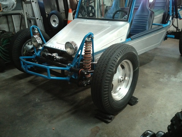

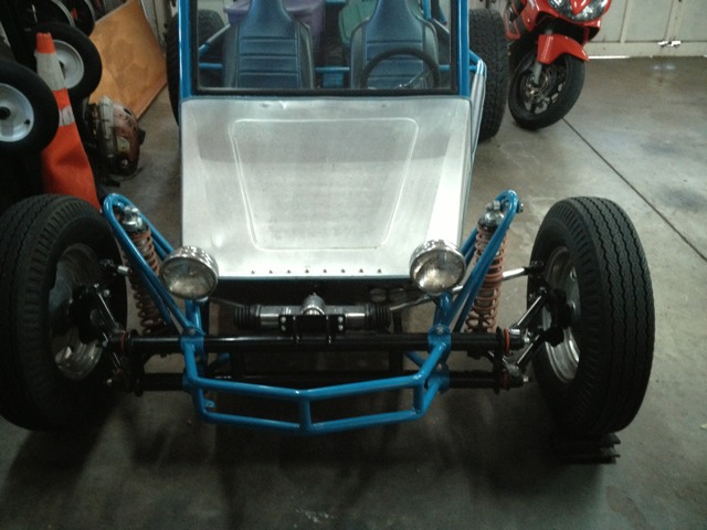

Here is what I converted mine too. It was originally the typical Latest rage self contained front beam. I kept bending it and I decided I need something stronger for the weight of this car. And no it has nothing to do with my driving and that's my story and I'm sticking to it! :wink:
Right after I built the Buggy:
Many, May Mods later:

Oh my it's another one of those threads,lol. :D :D :D . ( I miss nitromudder lmao). When you out flex your suspension then you start flexing your frame. Every frame I've had and seen with the top tube turned down to the front beam like yours has and will crack at the first upright support when you over extend the ability of your front suspension. With the added braces you put from the windshield down only made it worst for that top front bar by limiting the flex and made your front end stiffer and that's were your getting the harder feel from. The best fix I've seen is a combo of extending the top bar straight out and adding the bumper off it and "A " bracing down to the front beam and soften up your front suspension by adding more travel. Then again I'm not as smart as most but this IMO. Chad :mrgreen:
