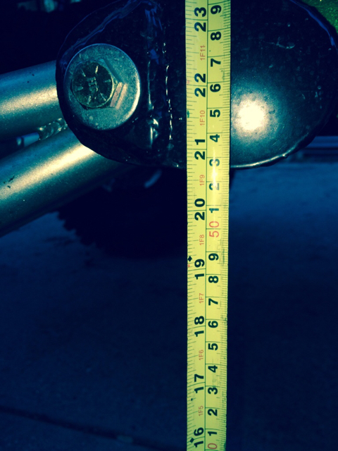

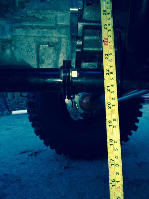

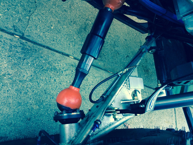

I installed my new axles and I gained about 3 inches of ground clearance. I am running 28 degrees at ride height and Max at 33 degrees
Here is the measurement at the torsion housing
Here is the measurement under the engine
