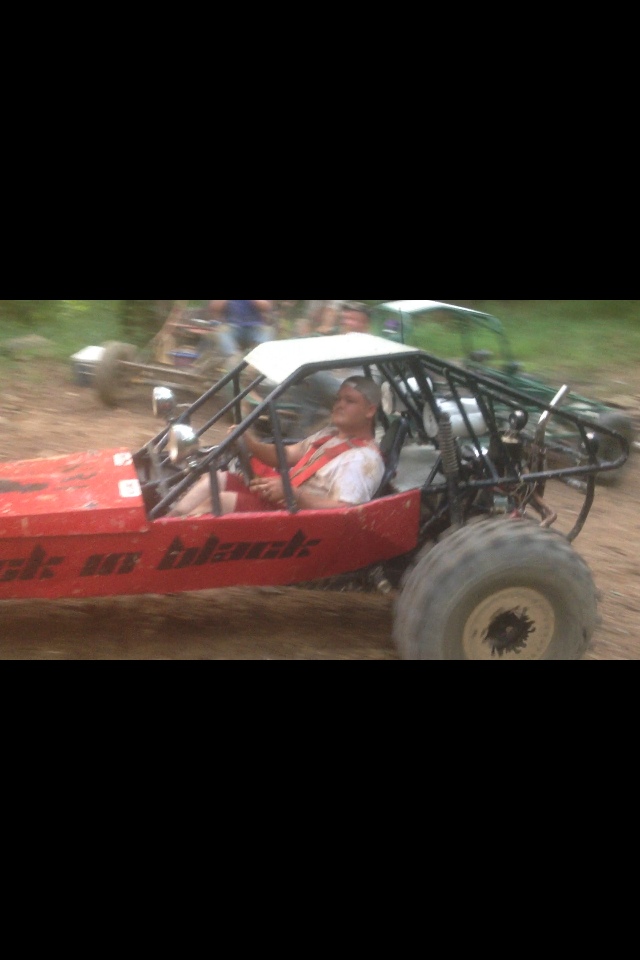

Big d u remember this buggy at wind rock. 1915 3rib 38's and we drove it as hard as u can run one. Never even broke a bus joint.

Hey NRI your pic didn't show. Is it that buggy I described above?
 Post subject: Re: Ground Clearance
PostPosted: Sun Nov 23, 2014 5:59 pm
Yea look on the reg website
PostPosted: Sun Nov 23, 2014 8:07 pm
Yea that's the buggy. I'm not worried about breaking. I'm worried about my low end for crawling around. I understand I will loose some low end torque......it's all about how much. I'm considering some 34x9.50. I remember the old days 4 wheeling the trucks had tall skinny tires and went great for trail riding in my area.
