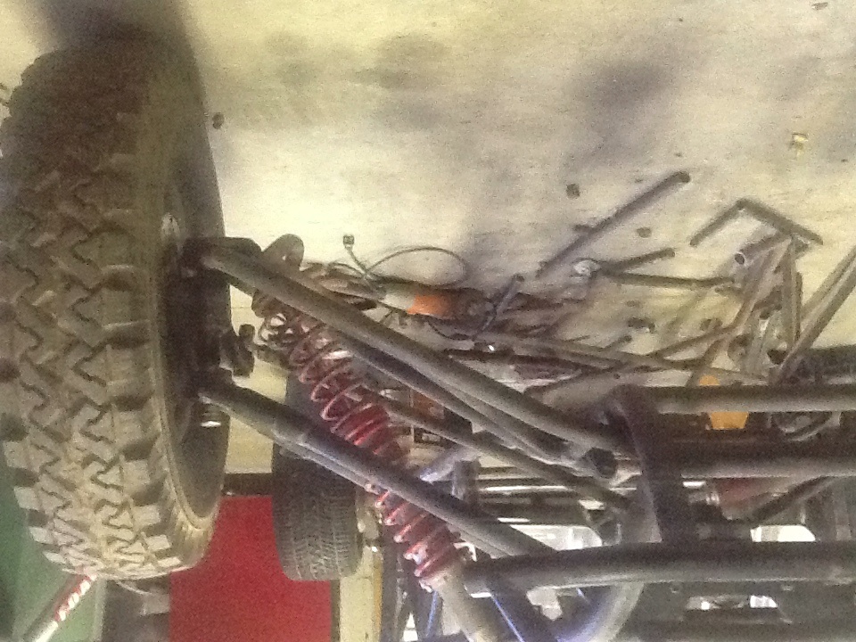

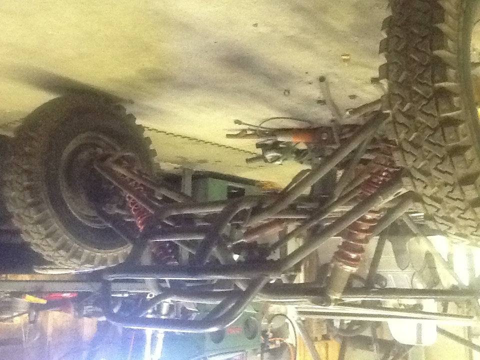

I'm running a-arms with drilled of drill spindles and kart ev uniballs ton of ground clearance and fully adjustable

PostPosted: Thu Sep 05, 2013 5:46 pm
I like that set up
PostPosted: Thu Sep 05, 2013 6:14 pm
Packrats set up is nice , I can't wait to see how it's works in the woods . It held together racing it. And a upside down pic don't count Donny ! Lol

Pack rat that looks killer !

Thanks,if you need more pics or measurements let me know,Kartec carries the uni balls and arm bushings

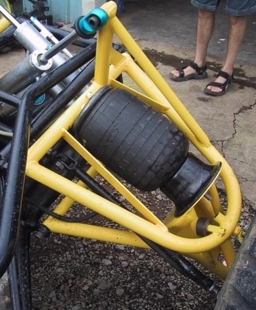

I think I can to.im gonna try one more twist I think im gonna try airbags on the front :shock: .it might not work the first time but with a lil patience I think it will.love`m on the back!!! packrat if you can put up some more pics it would be greatly appreciated !!!
PostPosted: Thu Sep 05, 2013 9:50 pm
I like the air bag on the front idea . I saw pics at one time somewere the bags were laying horizontal with linkage going to them .

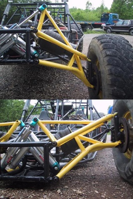

yes that is a nice setup.i wonder which is the best on the inside pivot points, heim or bushing style? Has anybody angled the arms up in the front kinda like a racing 4 whlr to absorb the bumps better?

Yes, Curt changed the a arm platform to help the arms take the bumps better. The arm moves up and to the rear slightly. A straight a arm would be a little rough on the bumps.
To do a a arm set up you really need to understand steering geometry like caster, camber, scrub radius, bump steer and ackermen steering. If not it will be a nightmare to control.
Heims would be the best just for the adjustability aspect.

http://www.woodsbuggy.com/index.php?opt ... =23&t=4403
here is link to the one we built
PostPosted: Mon Sep 09, 2013 3:40 pm
Thank you racebugg ,i was trying to find that post .That is a killer buggy yal built!!! if you dont mind i might pm you with a couple questions
