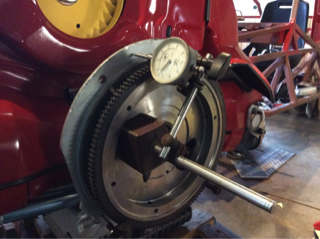

Can anyone tell me if can use hardened bolts from any hardware store,
or do I need special black automotive bolts to hold my pressure plate on. It's a VW 1600 200mm 8 Dowel lightened flywheel.
And I'm kind of confused on what to order online. Does someone know exactly what I should order . attachment=0]ImageUploadedByTapatalk1445119730.064875.jpg[/attachment]

I would think that you need grade 8 or better.
Here is grade 10.9:
http://www.partsplaceinc.com/products/p ... ?sku=16308
Here is 8.8:
http://www.mooreparts.com/874-AC141499
This kit comes with washers:
http://vwparts.aircooled.net/HD-Clutch- ... 141010.htm
