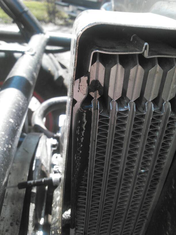

I have a dog house style oil cooler on my 1776 and for some reason my oil cooler keeps going bad.... the first time it happened was last fall, I rode all night and it was fine but the morning after I started it up and it started spewing oil out of the top left vent, and I bought a new one and rode all day last Saturday and was all good, but Sunday morning when i started it to get it off the trailer it did the same thing. I cant think of what would cause it to that. Help!!

Its coming out of the very top cooling vent, and i always let it idle for a while till its warm. If I figure out this oil cooler problem I know ill be there! But Phil probably wont make it... hes having motor issues, his end play is so bad its messing with timing and everything he needs to rebuild!

im still not understanding.."the very top cooling vent"!! :lol: so from the top of the oil cooler or the bottom where the o rings seal it up?

Its coming from there. Lol

hmmm.. well you definitely need a new oil cooler! maybe the shroud is vibrating on it up there? might try to do a little forceful maneuvering on the shroud when you reinstall. and maybe even put some thin weatherstripping in there. whats the chances of only you getting 2 oil coolers that give in the same spot!

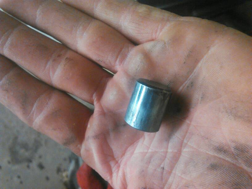

If it doesn't fall out with a little jiggling does that mean its stuck? The one closest to the pully practically fell out but the one back by the flywheel wont come out... how do i get it out??
 Post subject: Re: Oil cooler leak
PostPosted: Tue Apr 14, 2015 9:07 pm
Posts: 79
Location: fairland, in
This valve goes with the short spring by the flywheel doesn't it? And the mushroom looking goes by the pully?

The valve that is by the flywheel was stuck, I used a 1/2 inch tap to pull it out and wrapped a rag around a tire pressure gage to clean the hole out and it now moves freely so it is fixed, now I have to buy another 85 dollar oil cooler.. but I dont mind buying it this time because I know it wont happen again! Thank you jimp for your help its much appreciated!!
